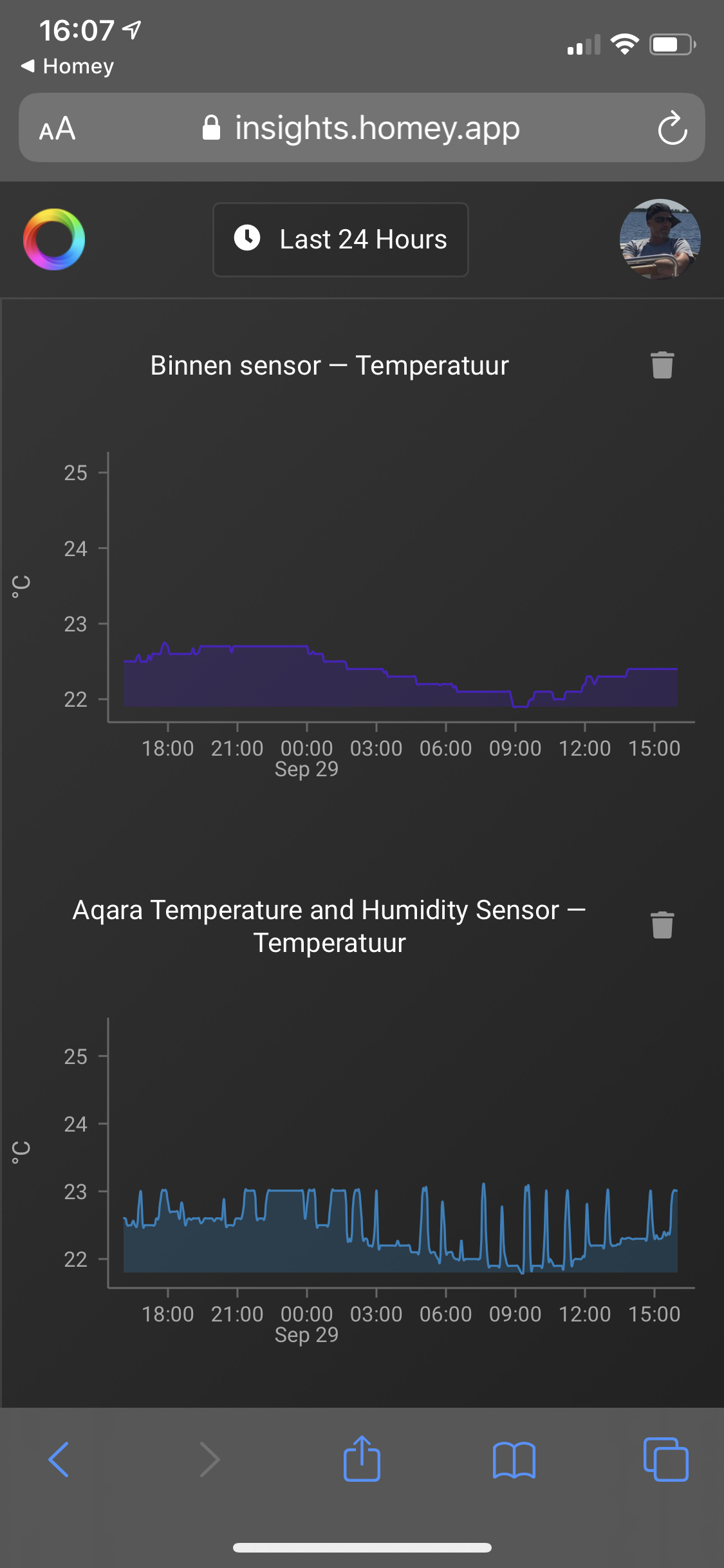

After latest update my aqara temp sensor ( incl pressure ) acts weird. It spikes to 23.01 degrees all the time. It does this next to my good old 433 temp sensor ( next to each other for testing ).
Also the weird thing is that i have it to 1 decimal in settings … and the spike is to 23.01
Before the latest update i did not have this issue
@Dennis_H74 that should be fixed in version 0.6.2 (awaiting Athom’s approval to hit the app store)
Top :+1:
