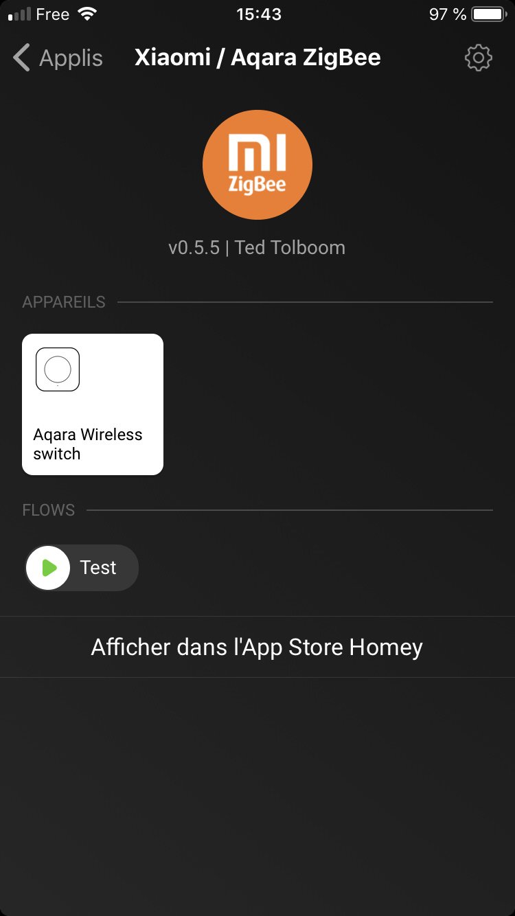

when i run the flow manually it works but when i press the button nothing at all
Can you make a screen-shot of your Flow?
it’s very basic at least to make it work
the state of my device

I have similar problem with aqara wireless switch (round version). After I add it, it works. I can run the scenes. After a while, especially if the switch is out of the zwave range and than returned back home (in car for e.g.), homey doesn’t respond to its presses anymore. Only way to make it work is to reinclude it again and rework the scene with newly included device.
