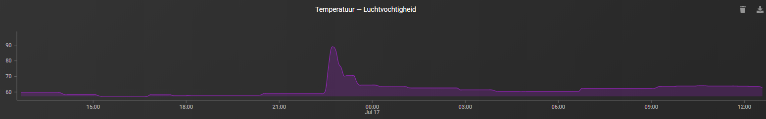

My humidity sensor picks up showering within a minute. I have a second sensor in the study and if difference in humidity is higher then 7% I start the ventilation. If lower then 5% I stop ventilation.
Can you tell when i took a shower?
70% is fan on
<70% = fan off after 5 minutes
works great!
