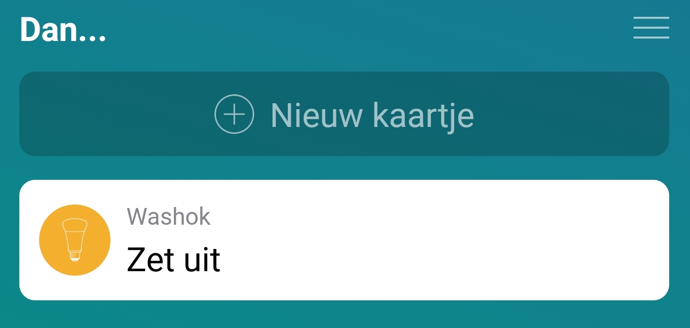

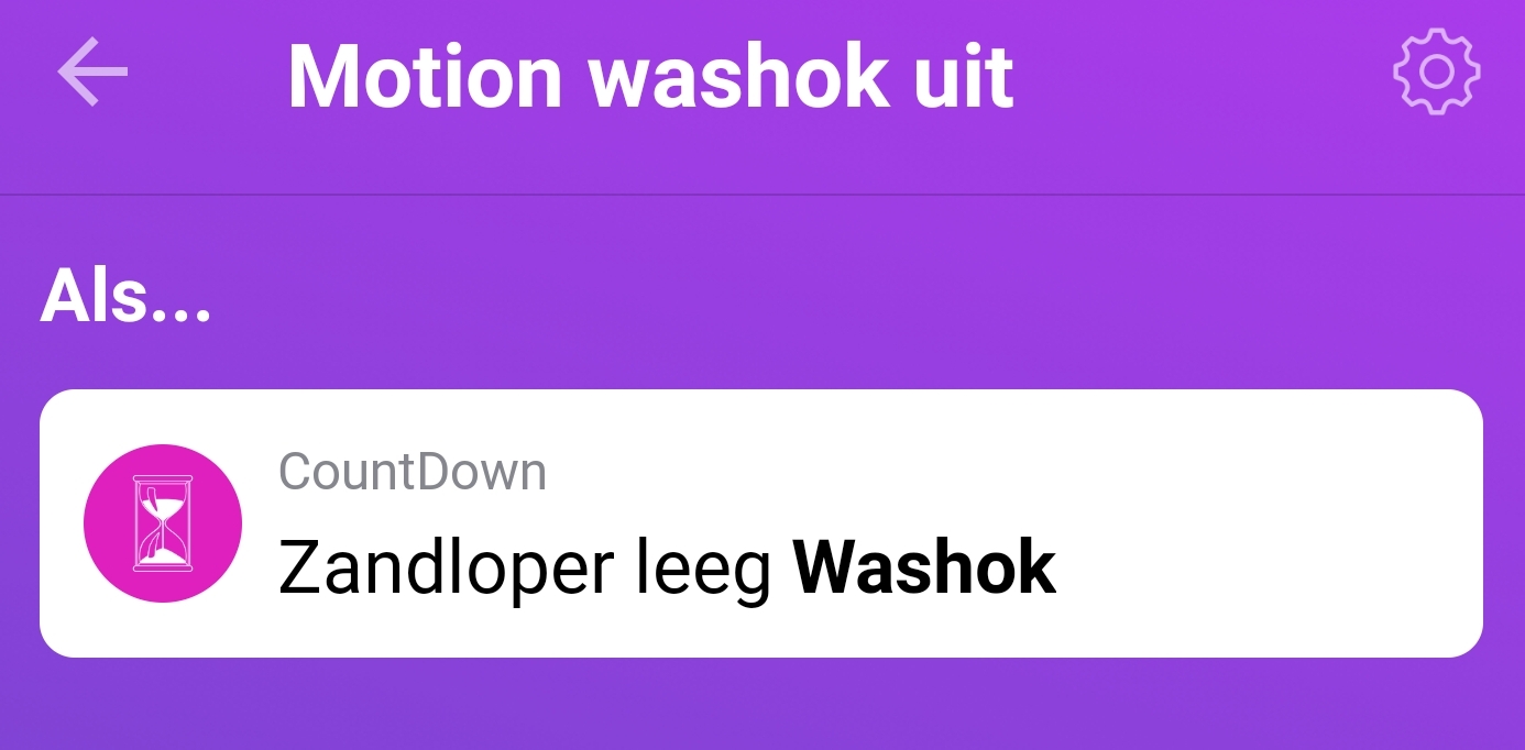

Have changed it a bit since it didnt work that good. If the sensor was triggered again the timer would start again but also ended after 90 seconds from the previous flow overruling the new timer.
I did this: created a timer âWashokâ
Motion set to 60 sec
Hourglass set to 80
Motion on:
IF washok sensor triggers THEN turn on lights at 100% and turn hourglass
Motion off:
IF hourglass washok is empty THEN turn off light washok
So everytime it trigger it will turn the hourglass. So i got 20 seconds between the sensor not registering movement before turning off, could tweak this a bit.
Motion on:
Motion off:
