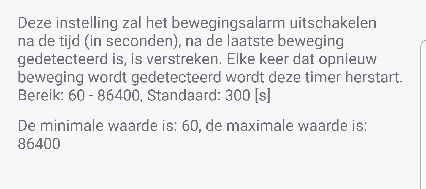

My awara sensor is set to 60 seconds, however the discription says it will reset the timer every time movement is detected.
I got the sensor to detect motion and turn a light on, it is set to 60 seconds. Every time im in range of the sensor the timer just counts down, turning the light off and then turning back on cause im still there. It should readding the 60 sec right? turning the light off after im gone, not counting down while im still there?SmartSelect_20190622-100810_Homey
No, it only can see motion once every 60 seconds. So after 60 seconds it will trigger motion again. So for turning on/of lights you need a countdown timer. WHEN motion alarm turns on, enable the light AND set a timer for by example 90 seconds. And in another flow; WHEN the timer is empty, turn off the light.
Thanks!
It is better to start an timer when motion turns off, in the flow that’s triggerd when the timer ends you make an AND card to check if the motion sensor is still off. When te motion is not off when te timer end’s you don’t wan’t that the lights go out. When the motion alarm goos out again the timer restart and when the timer end’s and there is realy no motion anymore the lights go out.
The problem is that the timer only restart when te motion has retriggerd… But when there is motion all the time te timer whill not restart en turn off the lights after 90 second even if there is motion…
