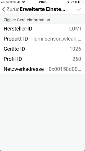

Hi, any plans to support the Aqara Water Leak sensors?
https://www.aqara.com/en/water_leak_sensor.html
It shows up as a generic Zigbee devices with these valiues:
IMG_1848
A search for ‘water’ in this topic is a pretty easy way to get an answer :wink:
Spoiler alert: only after a ZigBee update from Athom. Xiaomi / Aqara Smart Home - Zigbee App (v0.5.5)

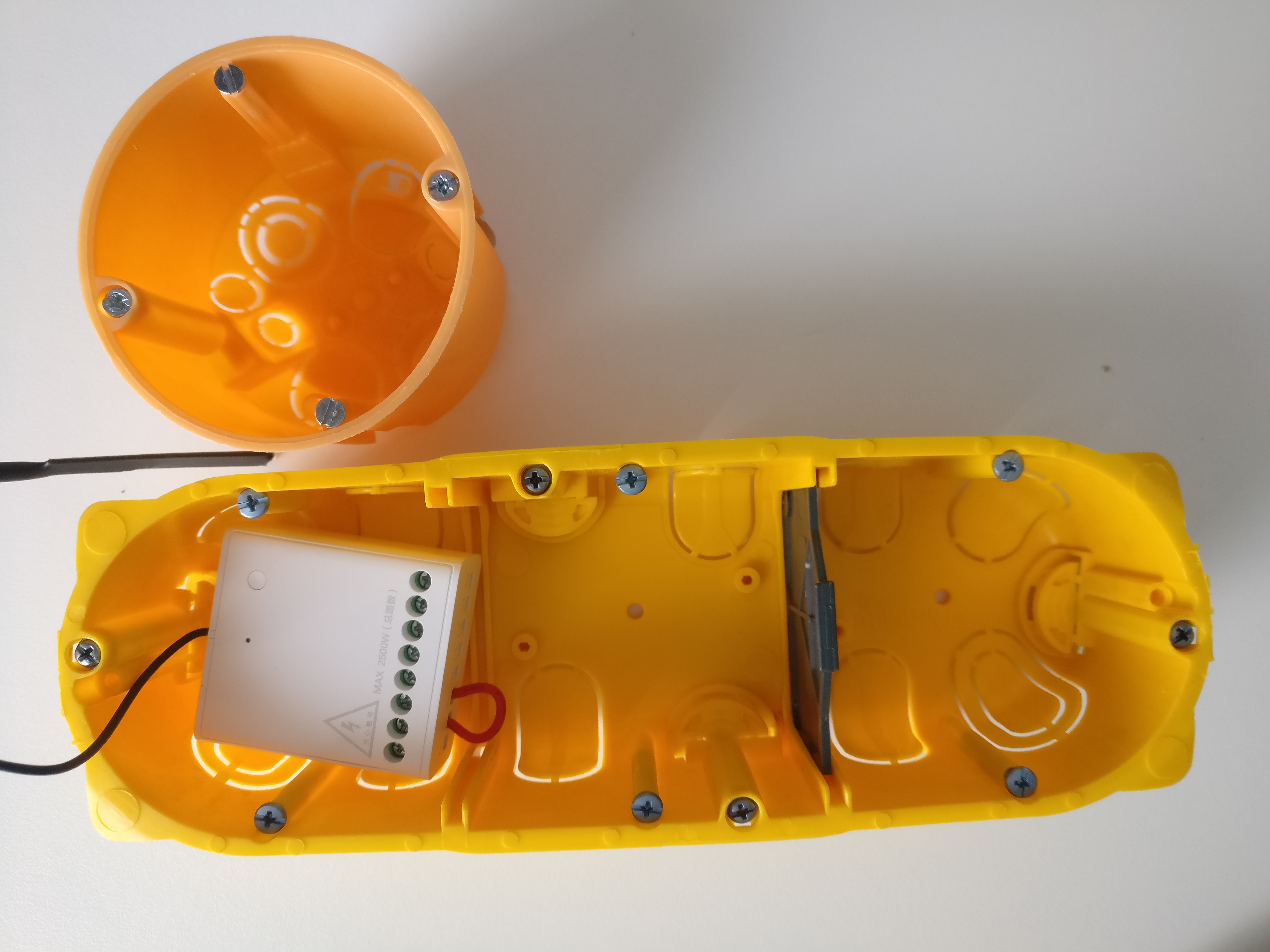

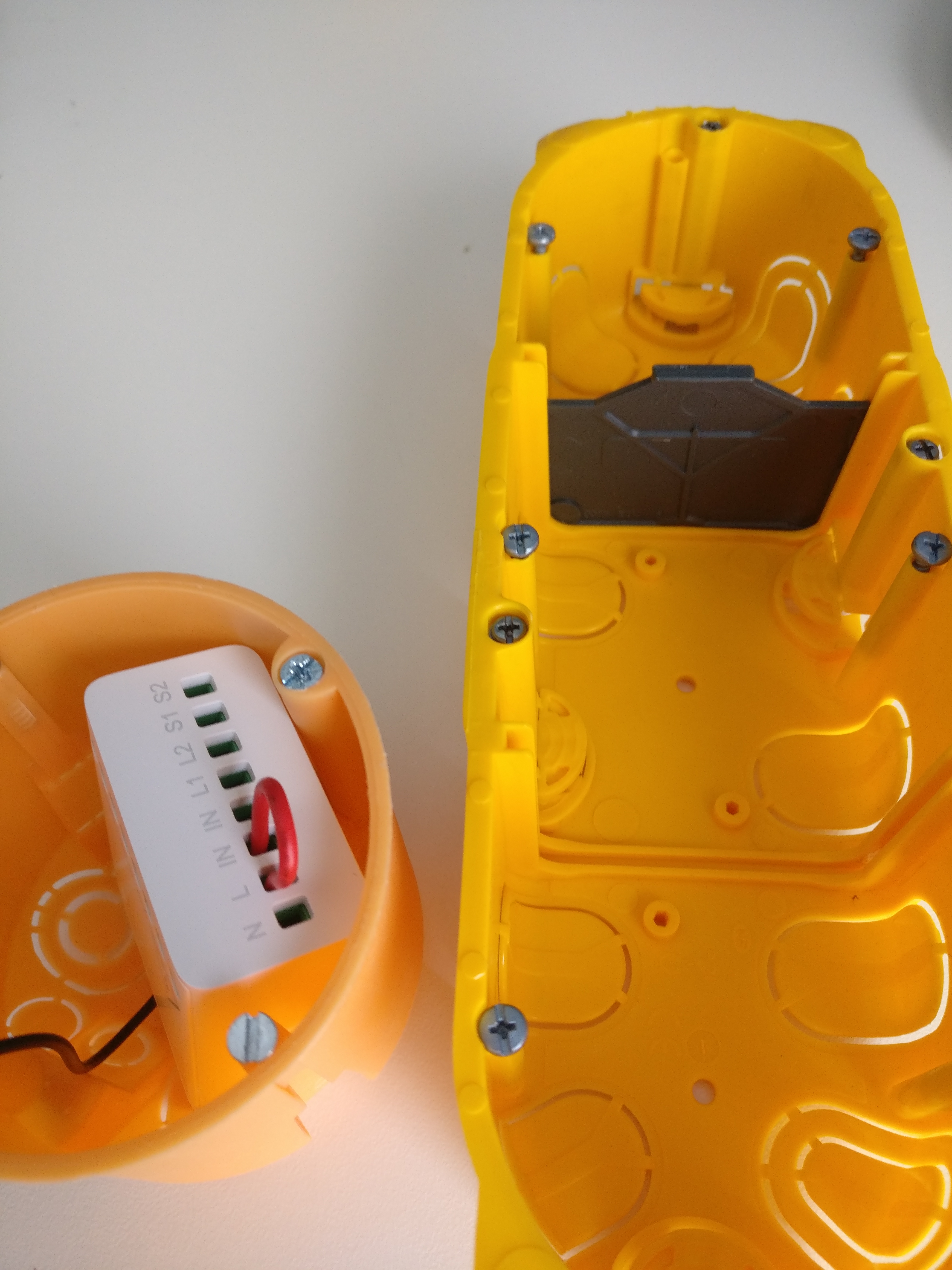

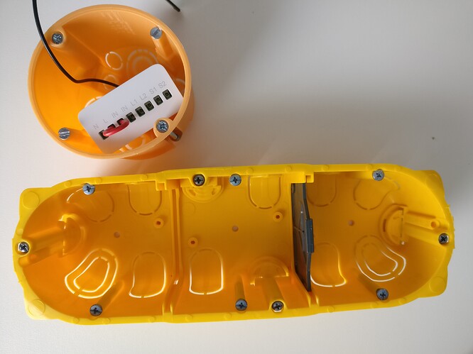

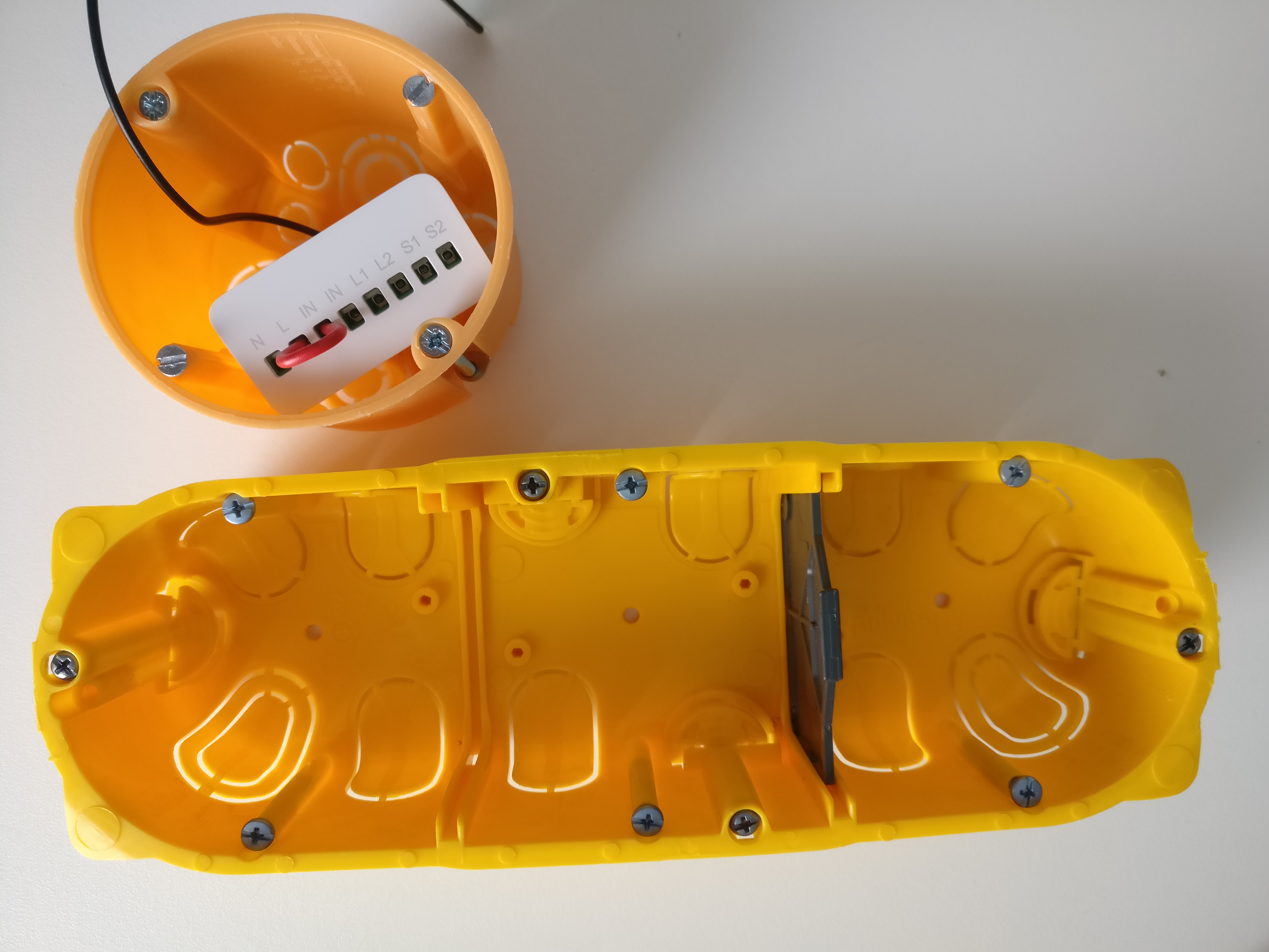

Well, this depends on your type of wall box really.
In a single ,68mm circular, wall box, it will fit but there is no room left for a switch.
In a multi-box, there is plenty room.
I expect it to fit correctly in a square wall box as well.
Because of the antenna (you can see it in the 2nd picture), I expect the range to be excellent.
