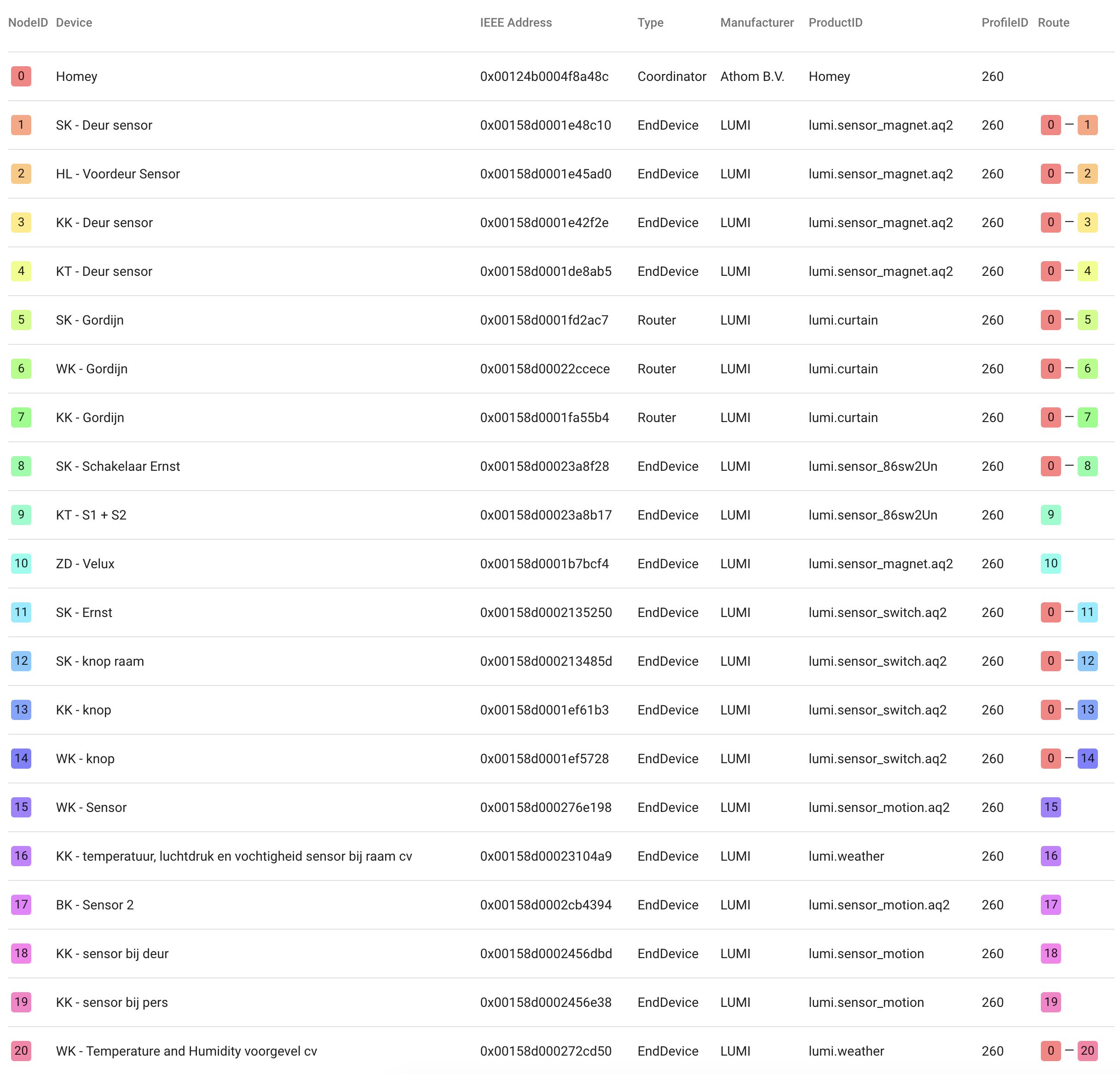

Okay but it is not a one time happening thing.
Every once in a while a sensor a button or bulb from not a specific brand does not respond.
When 1 look in the routing table the thing that not respond is connected to homey without a router and the coordinator is missing.
This contact sensor cannot have a range isseu as it is positioned directly next to homey.

This is the result of homey like it is said before if there is a ZigBee rewrite coming that solves the ZigBee instability and there is no timeline.

For all questions regarding loosing contact with Zigbee devices (including the Xiaomi and Aqara ones) / no proper mesh (representation): please contact Athom support: https://support.athom.com/hc/en-us/requests/new
As mentioned before, this side of the communication is handled within the Zigbee / Homey core and not within the app itself. And as others already rightfully mentioned; these problems are not restricted to this (Zigbee) app only.
