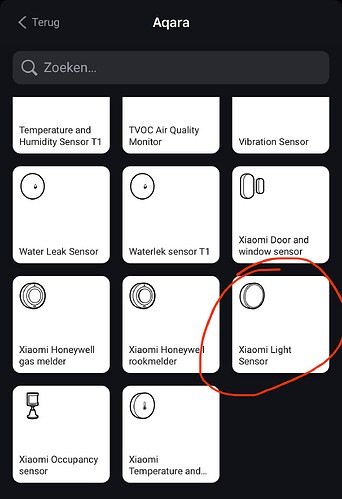

I bought an Aqara Light Senser T1 on AliExpress.
It adds it as an “unknown Zigbee device”
Am I doing something wrong or is it not compatible with the app yet?
See the pictures for more info.
If anyone has tips to make this light sensor work, I would of course like to hear them
I bought my Aqara Light Senser T1 almost a year ago. Still no support. I also asked Aqara Netherlands and they told me this device has no priority, because it is not sold in Europe. So I just bought the Aqara Motion and Ligth Sensor P2 and this device uses matter and works perfect.
