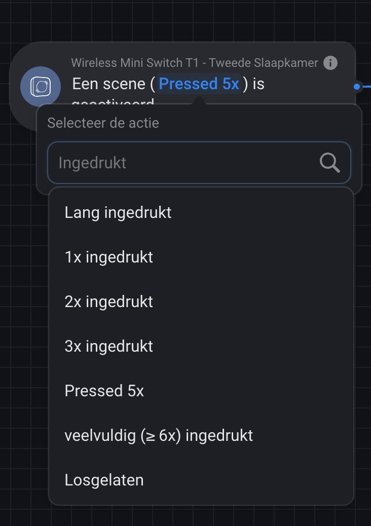

When using the Wireless Mini Switch T1 in flows I can not select pressed 4x.
5x is an option but 4x is not.
