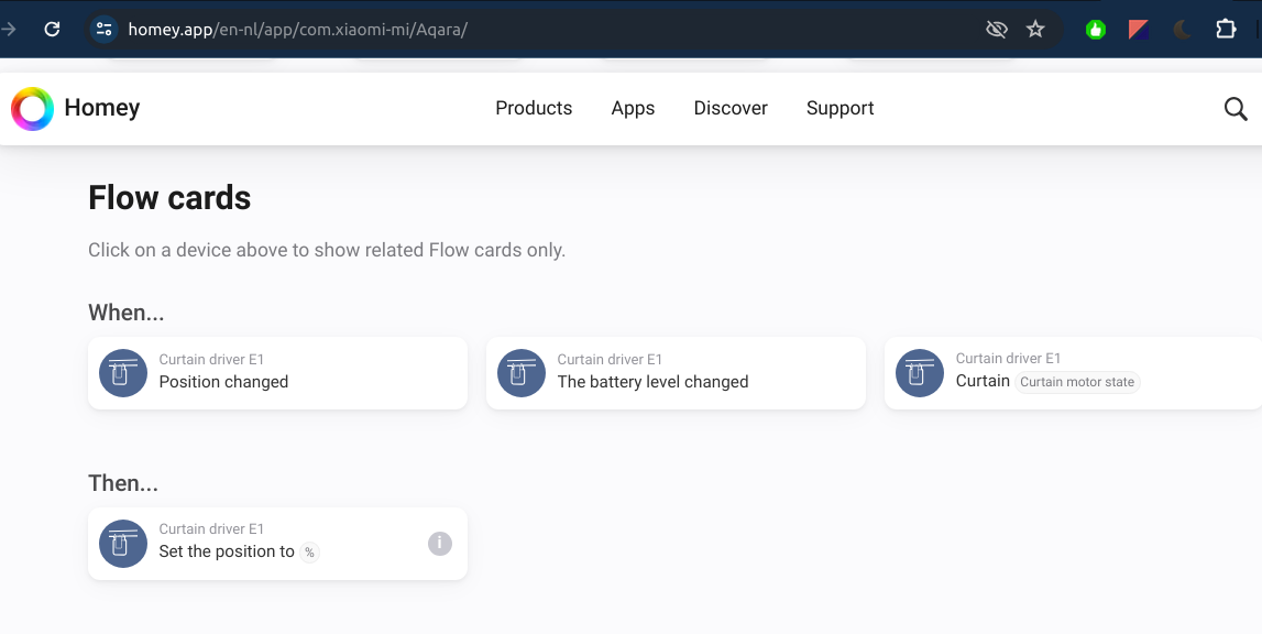

Is the Aqara E1 curtain driver compatible with Homey Pro without a Aqara hub. What are the control points that I can use to my flow. For example open/close and desired position %.
1st)

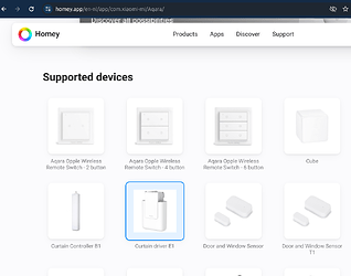

This info is available from the homey.app store;
Enter the brand name in the search bar → when found, open the app page.
Then look for the device, click on it, and now you can view the available flow cards.
(This is an indicator only, sometimes the actual app provides for more flow cards)
There seems to be only a ‘position’ card, so “Open” = ‘set position to 100%’, and “Close” = ‘set position to 0%’

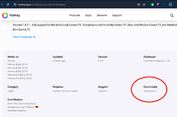

2nd)
Many apps have their own topic here, find a link at the app page! Use it, instead of starting new topics please.
Hi Peter,
Sorry for my ignorance, but do I have to purchase and install the Homey Pro App to download all the necessary 3rd party developed apps under Homey Pro. As I get the below error just to check on the compatibility. However, I have not yet purchased the HomeyPro, as I’m still exploring all the device compatibility before I make an investment for my smart home.
In the community forum, I did not see a straight answer on the compatibility of the E1 Curtain, but yes the Homey App store confirms the compatibility which has helped me in your illustration.
