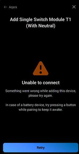

i found a solution that worked on all 3 of my new Aqara T1 Switches (with Neutral), just wanted to post it here if it helps anyone
I have a Homey Pro 2023 and got the error shown in the picture below every time i tried to include the switches, even with the homey placed directly besides them
It seems like Homey is “giving up” just a few seconds to early, this is what worked for me, but it requires correct timing
1.Start the search for a new device on Homey
2.Start the pairing process on the switch
3.When it fails, IMMEDIATELY press “retry”, and if you do that before the switch has ended its pairing process, it will jump out of the inclutsion process on Homey and the switch will have been added.
The error:
This is the same process i did the last few times and sometimes it works and sometimes not, but after some time they stop reporting power (switching still works though).
