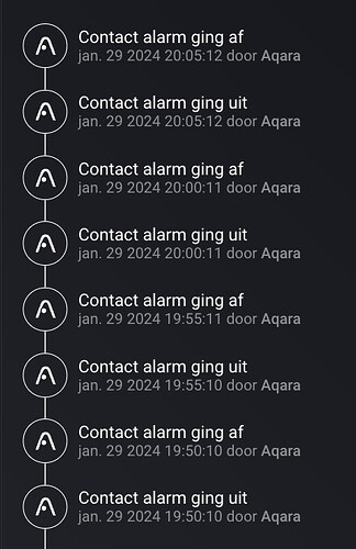

Are there any known issues about zone activity after migrating to Homey Pro 2023? I migrated last weekend and having some troubles with zone activity with my door sensors.
While re-adding the devices there seems no issues. But after replacing them to a specific zone and renaming the sensor, activity remains for 5 minutes. Besides that it looks like the sensor has a strange delay what results in strange behavior of my flows :frowning:
Repaired the sensor after migrating, delete an added the sensor but no solution at all… Anyone?

Did a little bit more testing for the last days. Door sensors are working fine while readding them. Active/inactive works fine when open and closing the door.
Only when it is organized in a zone, it stops working and keeps an open state for 5 minutes. Strange enough it remembers the times you open/close a door and keeps the zone that number x 5 minutes “active”.
So I thought this is not an Aqara issue but a Homey issue. But my motion sensors (IKEA) downstairs are working fine with zones and zone activity.
Anyone an idea??
