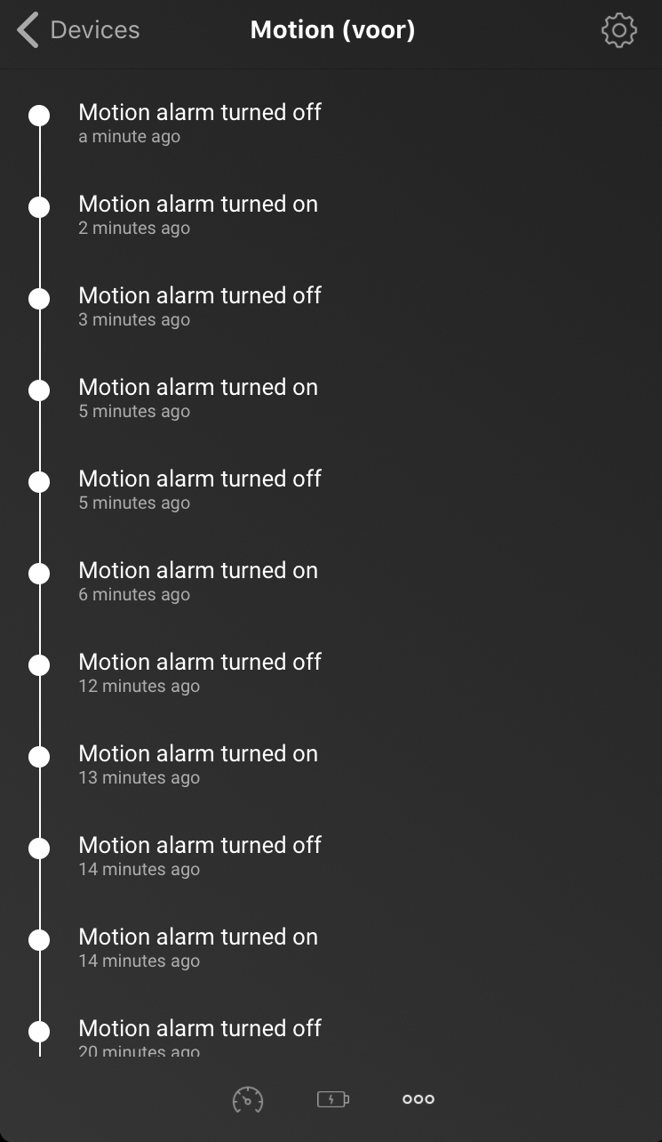

Yes, issue still present. Maximum 4 out of five motion sensors report motion alarm. It seems that always the last one triggered does not report motion.
I have ptp Homey for more than 30min.
There are no powered zigbee devices in my house. Only 13 battery powered sensors all Aqara, among them 5 Aqara body sensors.
I have brought them all close to Homey without any joy.

Same issue here, 2 out of 3 motion sensors report a motion. All sensors are Zigbee connected. I tried several actions but no solution.

I have the same problem, sometimes the human body sensors work sometimes they dont. One in particular is not working or has a delay of several minutes. I changed al the batteries and did a ptp to homey but no improvemends. Also the door/window sensors have a delay, sometimes multiple minutes.
I have 6 human body sensors in my House.
The one controling a light in the stairwell keeps giving trouble.
After a day or so, (sometimes 2) the sensor stops reporting at all. After switching batteries and excluding/including I got annoyed. And switched the sensor with another one used somewhere else in the house.
After a day the new placed sensor in the stairwell (which had no problems whatsoever) stops reporting.
Annoyed again I switch both sensors again. (Both sensors are back in their original place now). Yes again, the sensor controlling the light in the stairwell stops reporting.
