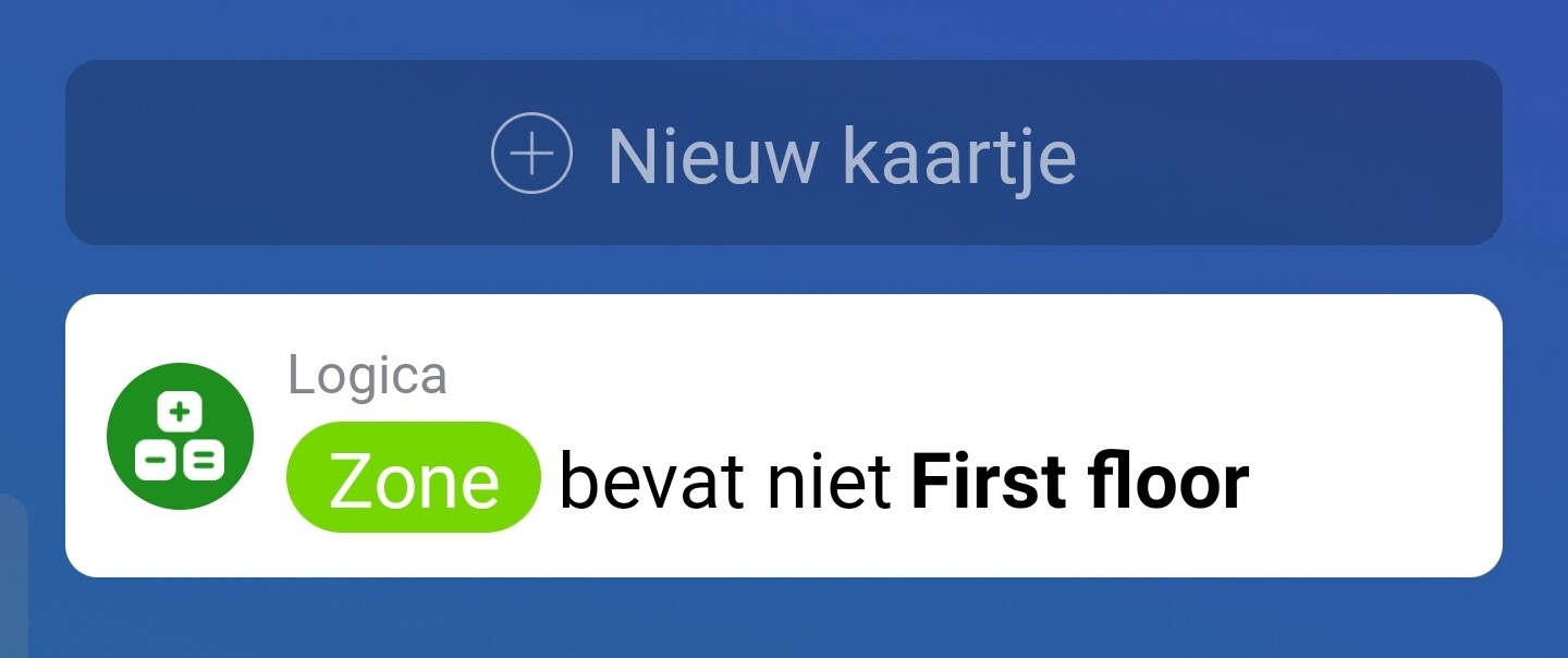

By using logics cards as condition, you can specify which zones / sensors
F.i. a flow like:
If…
a sensor did not report
And…
select logics card ā€œcontainsā€, and hit the tag icon
Then, under ā€œLocal Tagsā€, you’ll find 2 variables you can use: [Name] and [Zone]
-Pick [Name] and enter ā€˜Kitchen Door’, to pinpoint to only that sensor;
-Pick [Zone] and enter ā€˜Kitchen’, to monitor all sensors in a Zone called Kitchen
The same way you can exclude a zone f.i., by reversing the logics card, so it says ā€œDoesn’t containā€
