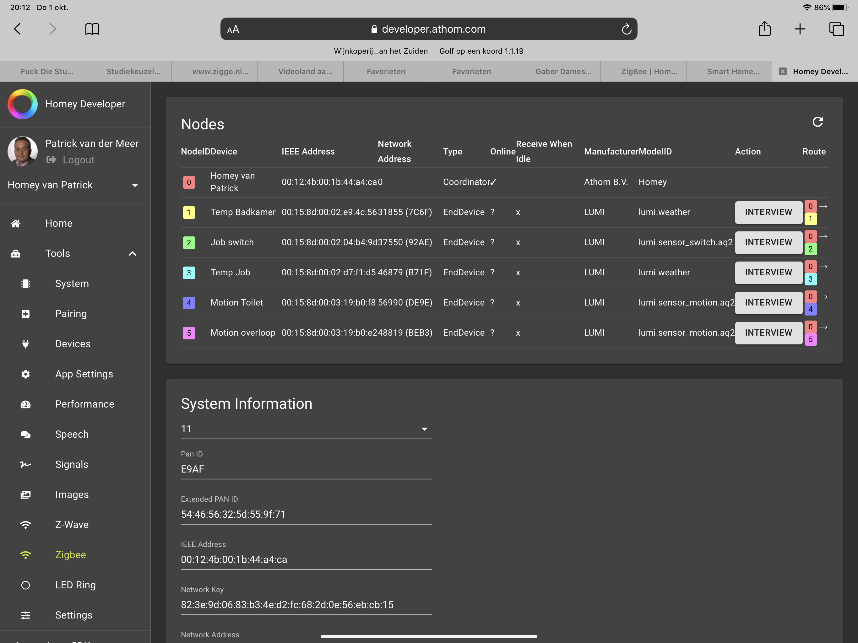

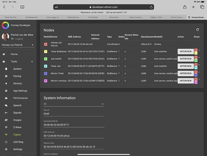

Today i added my xiaomi sensors and it seems to look perfect. My old flows are working when added a new card with the device. See picture
After that i tried to add more of my sensors (door and window, wireless switch) but i canât. There is no respons when i hold the button on the sensor for 3 second. Strange, because i added the same devices earlyer and all of them are working.
This screen appear and stays till i close it.
Do you have any ideas?
Itâs the same for me!
