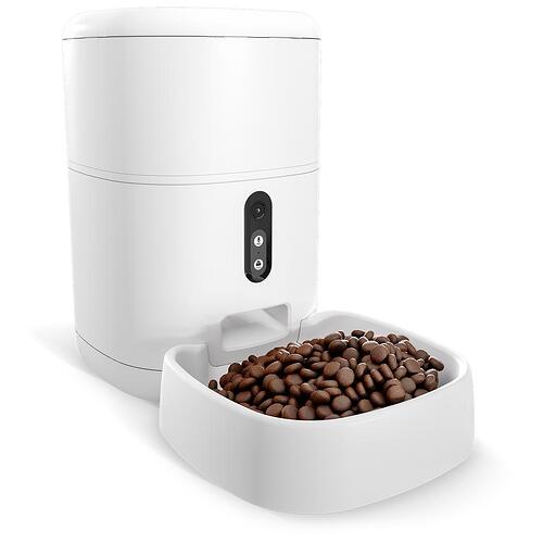

I want to buy a pet feeder that is supported by Homey, and haven’t found any on the devices list yet. I’m wondering if there would be any luck that if I buy a Tuya or Xiaomi one Homey will pick it up through the Tuya or the Mi app?
What is my best bet to see if those devices are supported by Homey? And maybe there is some work around to add them via some obscure app/method? Been reading and searching a lot through the forums but feeling a bit lost on finding this out on these seemingly ‘niche’ items without any experience with Homey yet.

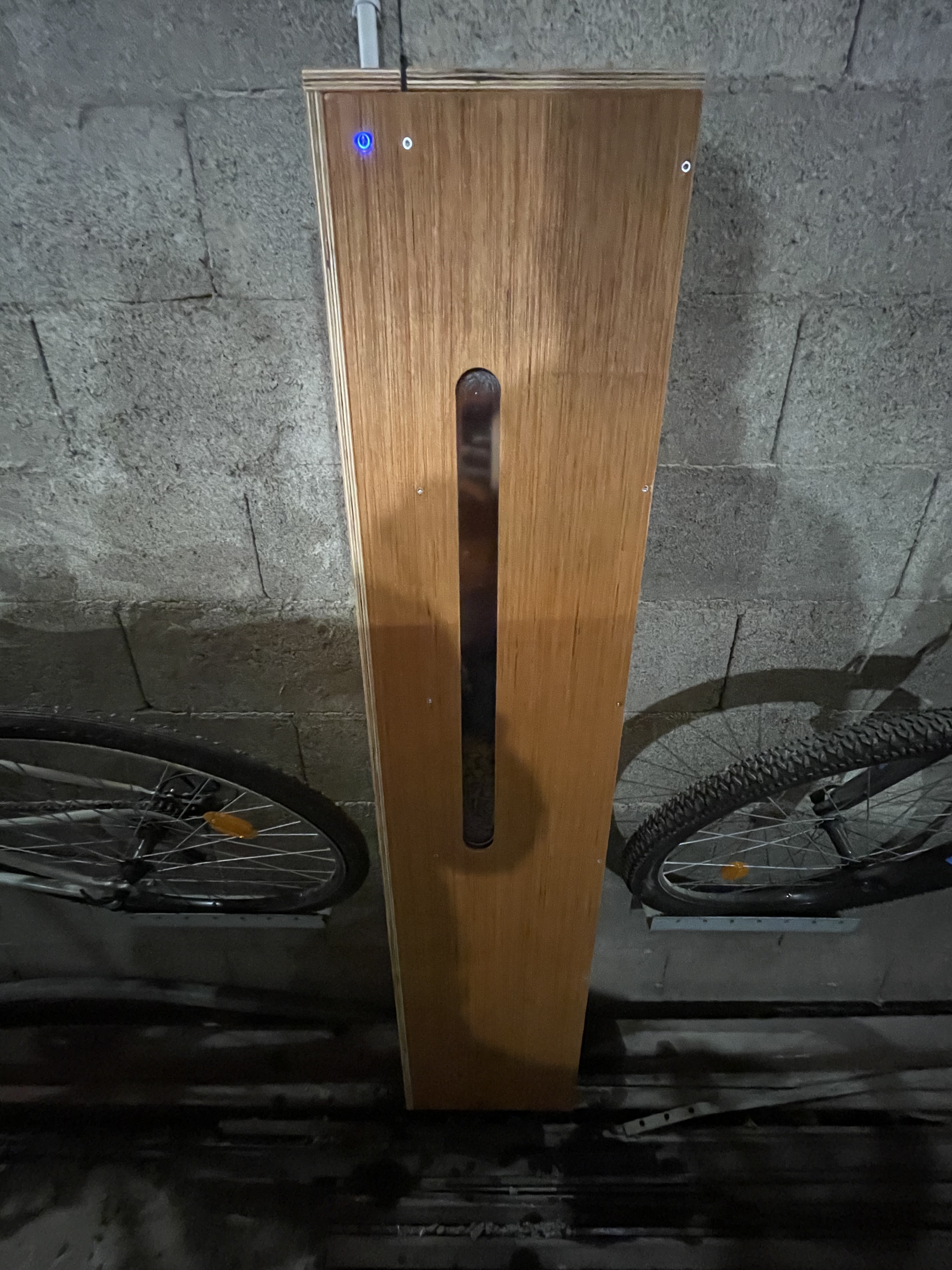

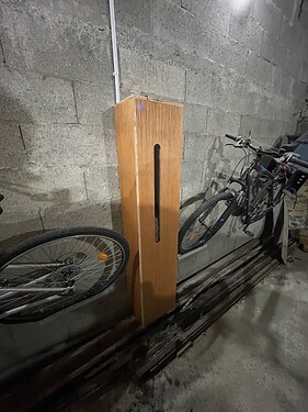

I made mine last month. I used:
  • a Wemos D1 mini with Homeyduino to control distribution with flow (15€ for 3 wemos)
  • a relay 5v (9€ for 5 relays)
  • a motoreductor (20€ for 1)
  • a 12v power supply 15W (11€ for 1)
  • a pulley with belt (13€)
  • a SR04 sensor to check the volum (optional, 5€ for 1)
  • a button (optional)
  • 3D Print
  • a wood panel
I can share fusion plans if someone is interesting. I can stock 15Kg food.
Behind the wall it’s the kennel, i fixed the metal dog’s bowl on the floor to be sure the food goes in.
