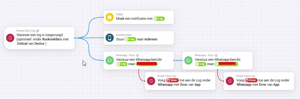

Dit is mijn notificatie flow
Deze handelt alle notificaties af

Ik zou die logica wegdoen, want je syslog heeft al die logica controles erin zitten.

No devices for Simple (sys) Log necessary?
Maybe I need to fill in or change a name somewhere?
OOPS, did this in Dutch. sorry.
@Willem59 Nee hoor. Je kan anders die SimpleSyslog weglaten en direct push bericht/tijdlijn doen in de flow.

I have quite a lot of fire and heat detectors here, which is why I thought the sys log was so useful: it saves a lot of cards in the flow.

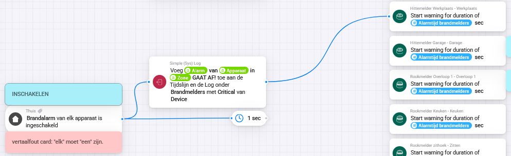

I copied almost everything.
Here is part of it.
2 questions in the screenshot.
1: could this when-card be skipped? You always want to set the alarms off, when one is triggered, no?
2: when the error messaging coud be done in this way, that would mean a lot seperate cards less. The chance that more than one is broken seems small to me and it is enough to know something is not working, I wonder.

@Willem59 yes. But if you turn it off the button. The others will not going on. Maybe if you’re quick enough.
2 I don’t know because every error variable is unique from the device
