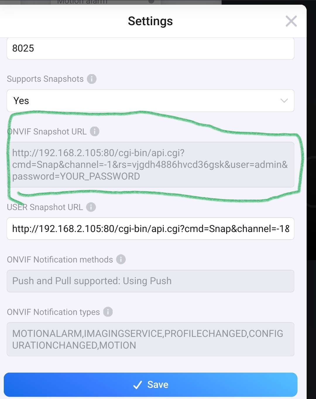

I’ve two Reolink cams, one has the same problem you mentioned, because it has no webserver to provide for the pictures.
You can test it in a browser, by copying the URL mentioned at cam Settings > Onvif Snapshot URL , like this one from my cam:
In these cases, you’ll need a specific app written for your cam brand/type.

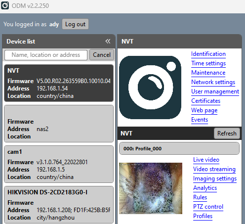

Test tool:
