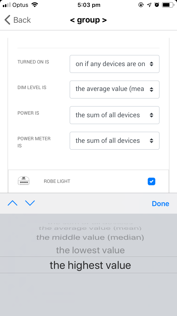

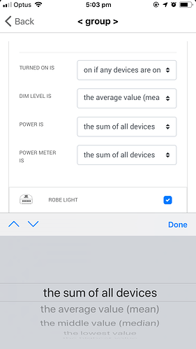

Go to more - settings - group. Click on the group you created and change the value from “sum” to average.
I only have the sum, for energy the max, min and averege cannot be choisen.
Screenshot_20190428-095016
Odd, when was the last time you updated the app?
Oh, perhaps you using the Power Meter rather than power measure.
Power meter capability is used by apps to show the total amount of power used by a device - since the beginning of time.
As this value itself is the sum of the kW⋅h returning anything other then the sum is rather pointless to the vast majority of use cases.
