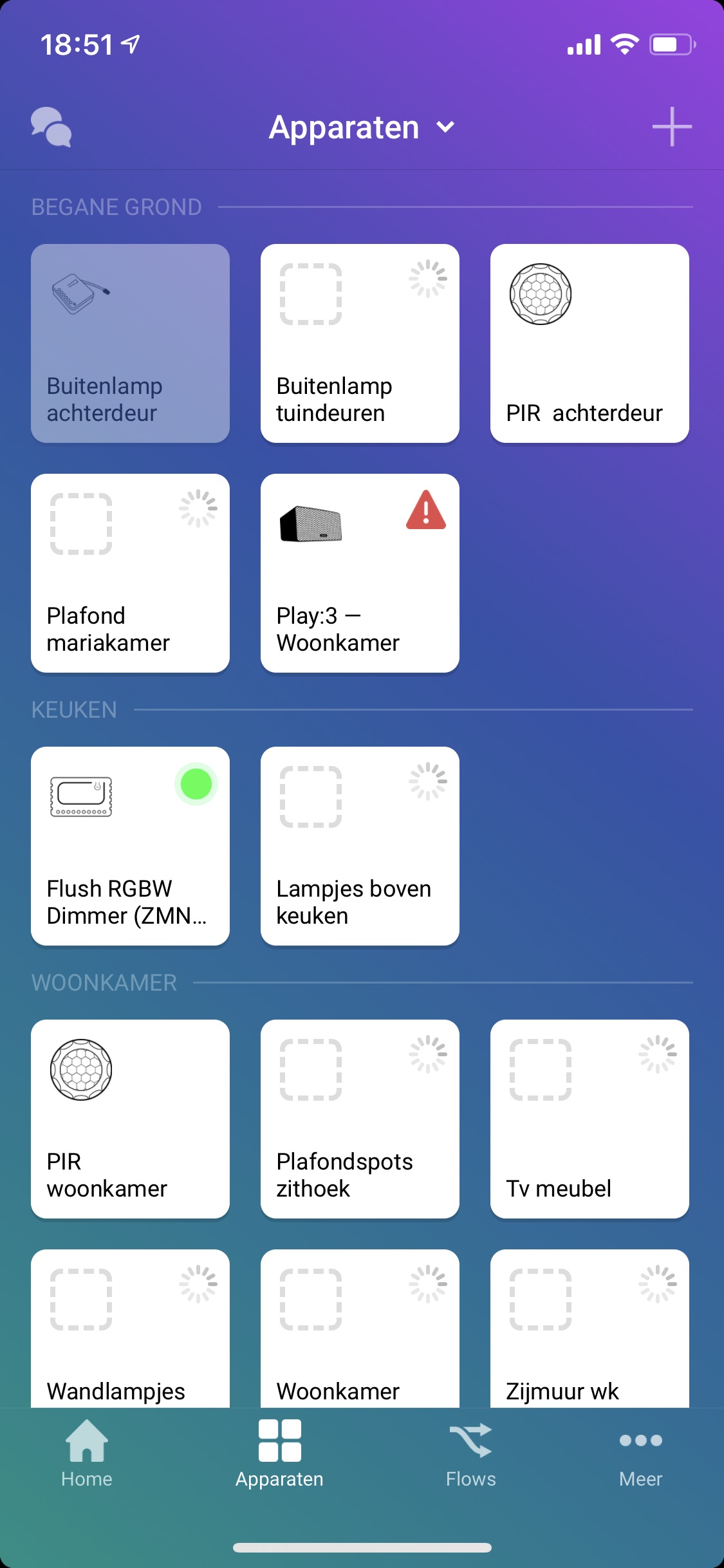

Today I wanted to add a qubino rgbw dimmer. That was not supported in the stable version of the app so I was advised to switch to the beta version.
I was able to add the rgbw module now, but all existing modules ( 15+ flush dimmers) are stuck at the message ‘Device is starting up’ . No Change for the last hour.

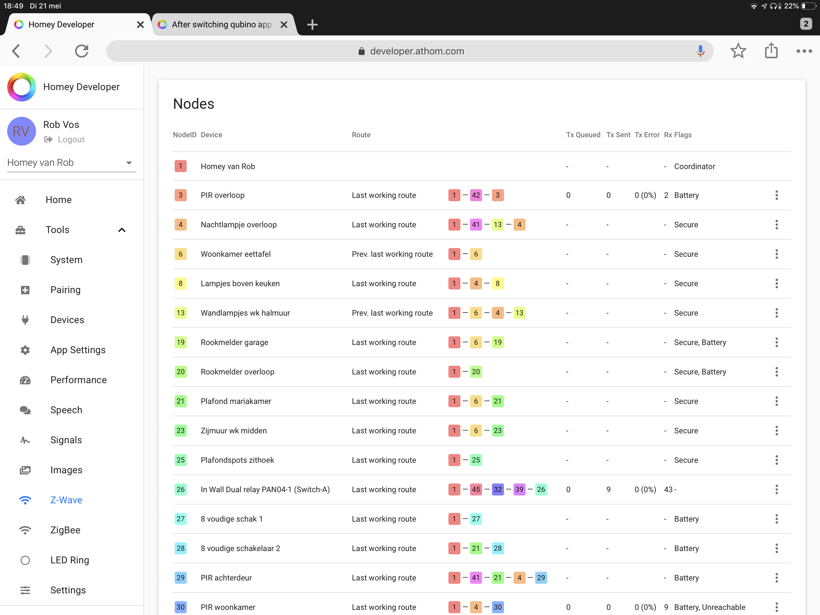

The developer view even shows all the devices still, even actions get an acknowledge. But when I open the app, all devices are grayed out and show the spinner.

Yes it is, the rgbw module even works fine so the apps runs ok. A restart of the app also didn’t help.

The Developer page looks fine as you can see.

hmmm, the developer page doesn’t look fine though.
all TX and RX are null (-) instead of 0 or higher like they should be.
I fear that you still need to re-include those devices, but i would first give Athom’s support a message.
