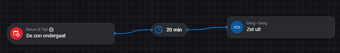

I would like a flow to turn off lights 30 minutes after sun rise; all I see is before sun rise. Any thoughts?
When the sun rises
The turn off light-delay 30 minutes.

Using the Date and Time and a Wait should work
