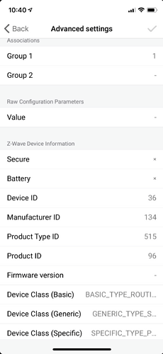

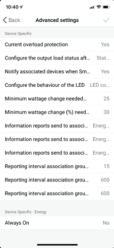

Settings for my device

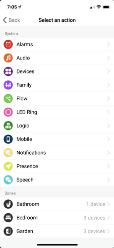

I was looking to see if I could do as you showed but there is no system option for me in my homey, I have a System section but nothing I can select that has anything like you showed.
See below shows of my interface,
You probably have to switch on “Poweruser” in Experiments ( More - Settings - Experiments - PowerUser )
