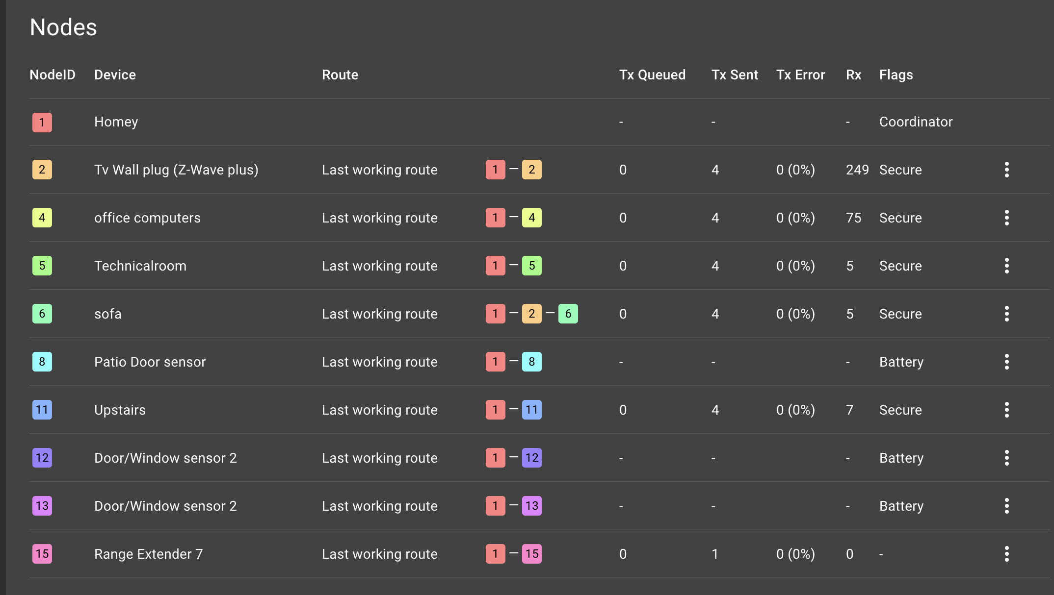

I added my range extender 7 to my homey with the beta 5 rc firmware. Somehow I don’t know how it should work? it is there, but not secure and I don’t see any routes where this extender is used. With fibaro I see it sometimes this socket between devices.

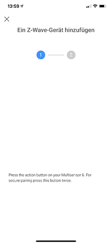

At the moment it seems to be the only possibility if the device is capable to choose between “Unsecure” and “Secure”, e.g. by a single click or double click (see screenshot of the Aeotec Multisensor 6).

good news I saw at least the route
it looks like homey is preferred way of connecting and if not it uses the range extender.

Maybe a stupid question but… where can i view this screen on my system?
Go to Homey Developer
Thanks! That’s really helpfull…

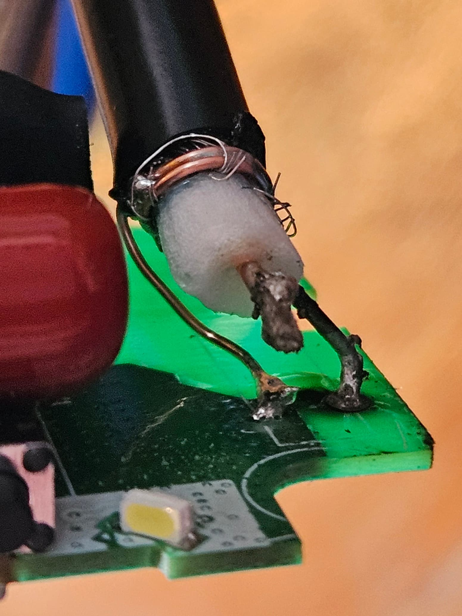

Disclaimer :warning: note: the device I made is not safe :zap:

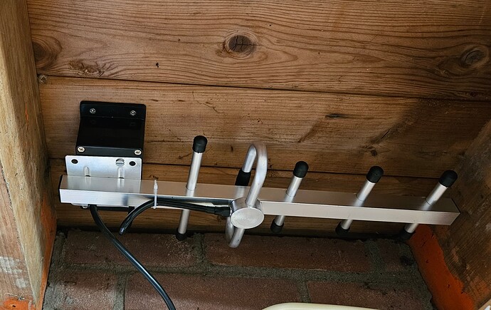

Had some devices in my garage, where i could not add the range extender either.
So took drastic measures:
Bought a €8,- yaghi 900MHz antenna with 8dB gain. (Eu zwave is on 868MHz)
Some soldering (not as easy as i thought… The printed circuit of the Aeotec 7 is fragile and multilayer. )
I mounted the yaghi on the lid of a little box, fed 230v cord and the coax of the antenna through the lid and soldered the coax instead of the coiled mini antanna on the board. Note: i scratched some of the “minus” plane on the PCB for the sheet connection.
The easiest way to solder a sheet is to unstrip a piece of thin solid wire, wrap that around the metal sheet and solder it. Then cut away the rest and keep the inner conductor possibly short.
Now my connection goes 15 meter through some walls and is 100% , no bit errors :sunglasses:

There’s a reason why these devices don’t have an external antenna: risk of electrical shock because there is no separation/isolation between the mains “ground” and the antenna (and this device seemingly having a capacitive dropper as power supply and an unpolarised plug makes it especially dangerous).
Good point, Robert. Probably for safety i should have used ground for the antenna too. It could improve antenna function but still it’s not EN90650 standard :blush:
I did polarity swap and measured no “hard voltage” but it’s not safe, correct.
