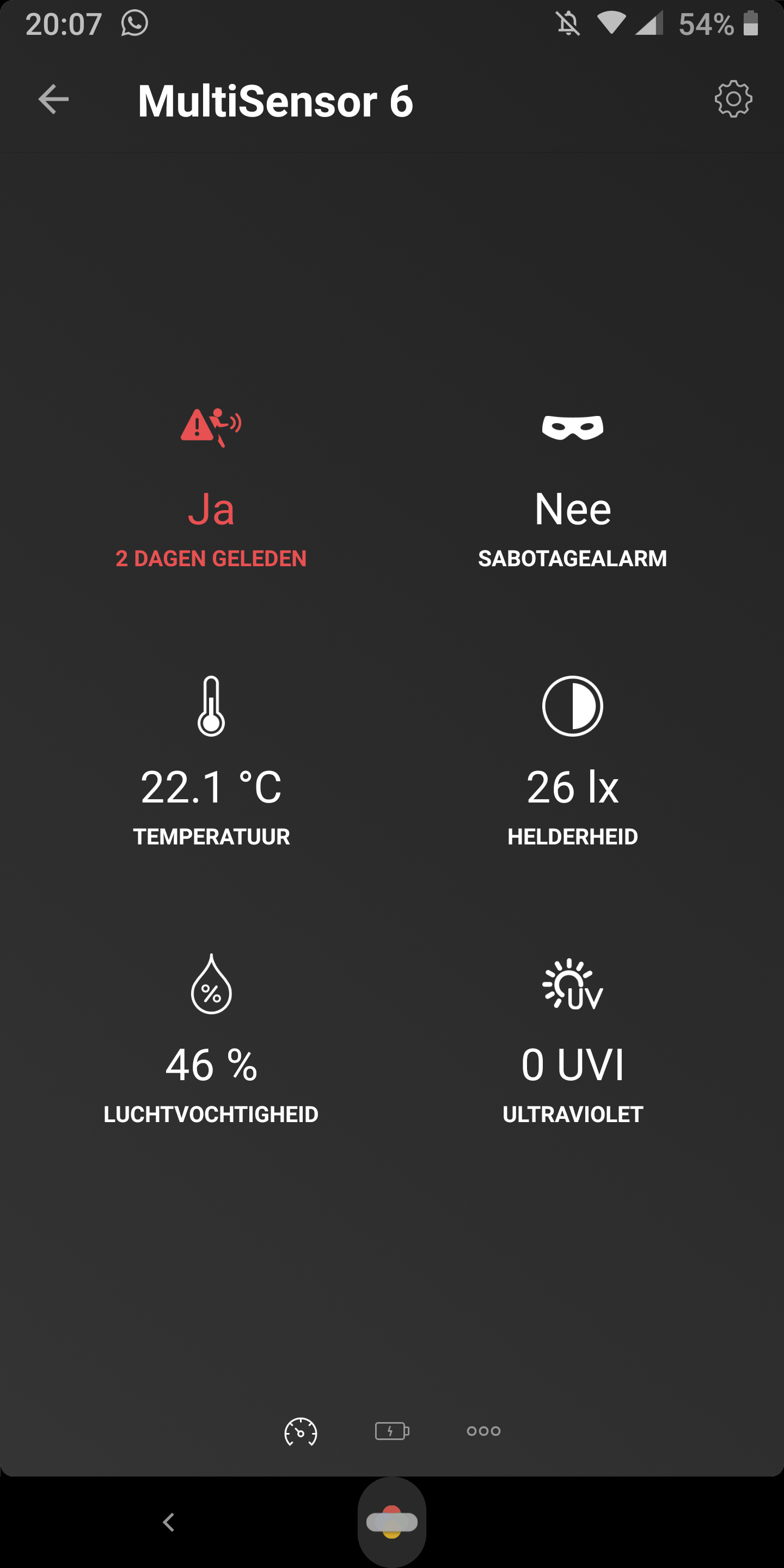

Hi, I’ve got a problem with my Aeotec Multisensor 6. Apparently there’s something wrong with the sensor. The led is constantly changing in colour and it doesn’t sense any movement. It is USB powered.
Please advise.
Regards Bobby Screenshot_20190429-200801
If the LED is constantly changing the colour means that your sensor is excluded from Homey. Weird, indeed, since you can still see it in devices.
I would try the following:
1.Go to developer tools here: https://developer.athom.com/tools/zwave scroll all the way down and click Remove Any Node then push one time the sensor button. If successful you should see a message on a green background.
2. Include your sensor again on the normal way.

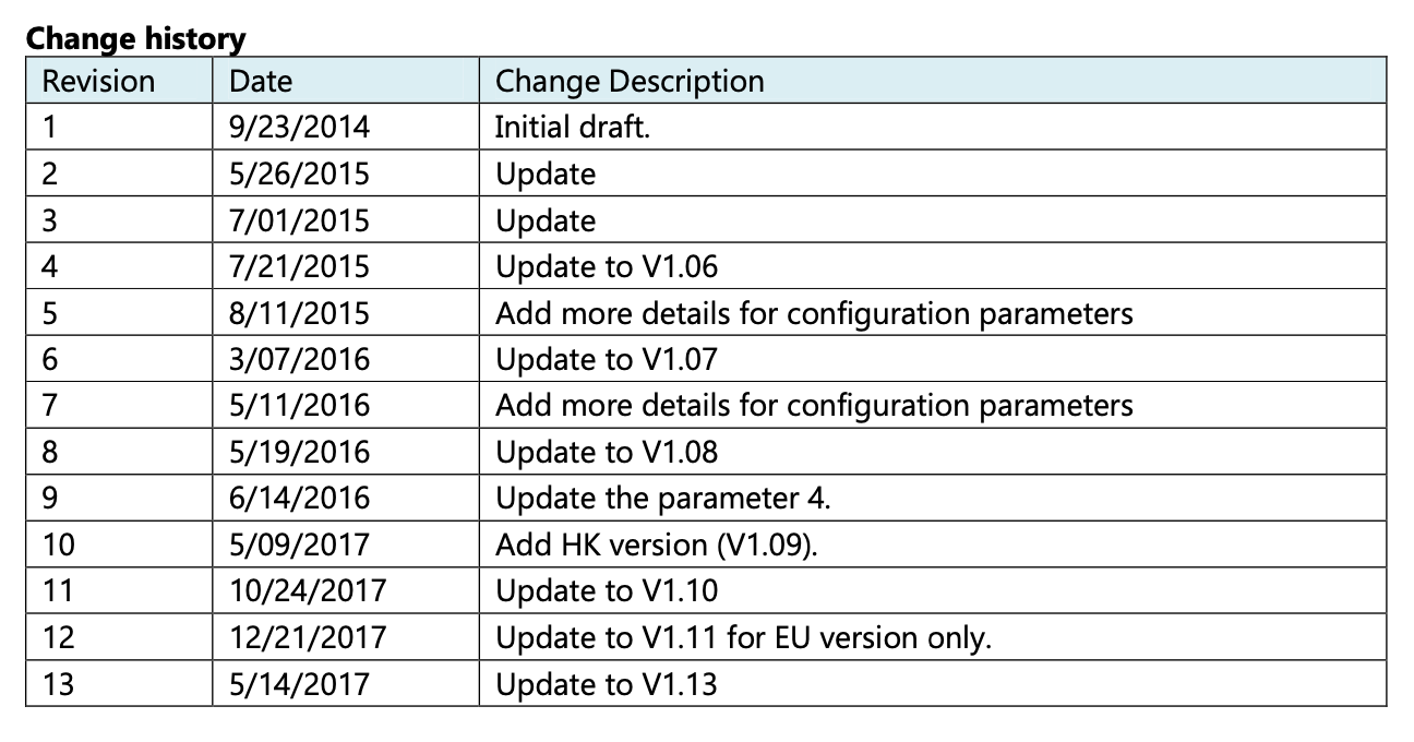

This is the actually firmware version of mine MS6:
Bildschirmfoto 2021-07-05 um 10.32.27
It’s also weird, because this is the change history of the fw (source):
Fw 1.12 is not listed, and your’s 1.14 isn’t listed at all.
Don’t know if it depends on the Z-Wave frequency.
