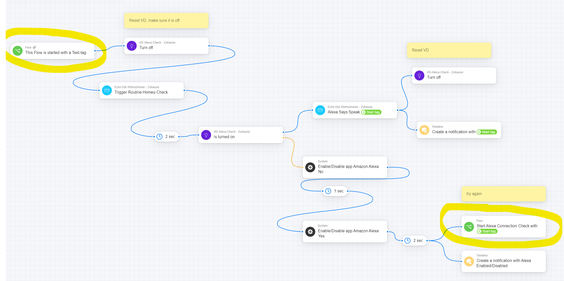

I think it works as in the past, loops are not forbitten. Loops will recognized and homey stops the flow if a flow is called to often.
Just an example of a flow which calls itself with its start tag again:
