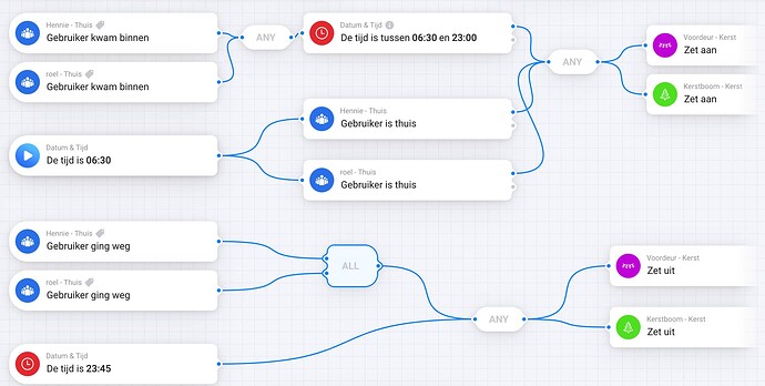

i having some problems with a advanced flow i made
The flow doesn’t works when Hennie and Roel are not ad home (leaving home)
NEVER connect to inputs from an ALL on different triggers! That doesn’t work !
Proof:
Both triggers are executed with Action Top Left and create Work#1 and Work#2 on the Timeline,
However the middle Action behind the ALL will NEVER be activated:
You should almost think Athom should add a warning when someone wants to use the ALL block :grimacing::wink:
