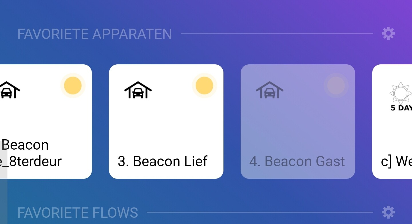

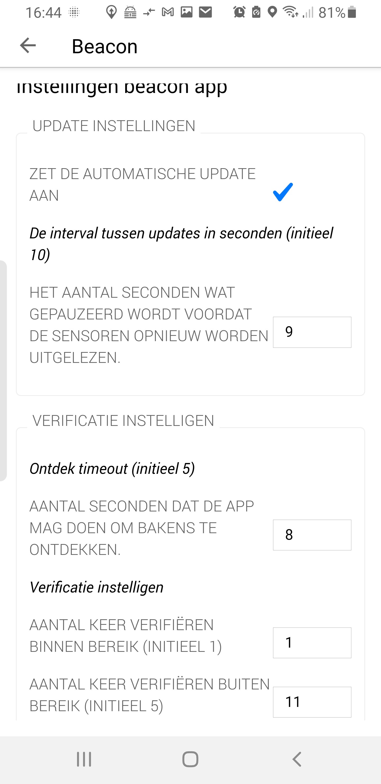

I will share my flows for 1 beacon and the beacon app settings, b/c it took a while to get rid of false positives.
For the status, I created a virtual “light”, which is set to on/off by the Status flow.
(The beacon icons themselves don’t reflect the status, so I put them in a zone called z_NotToBeOperated)
Flow AtHome
Flow Away
Flow Status
Beacon detection settings:
Here how the status tiles look:
