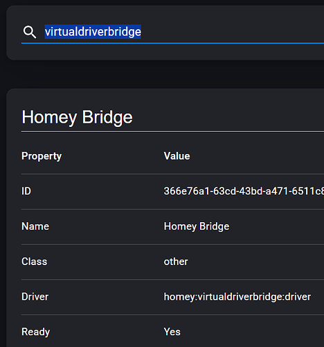

or go here: Homey Developer Tools
and Search in all your devices for: virtualdriverbridge
btw:
How did you notice/conclude that ?
Thanks Dijker for your input!
I see it now in the Homey Developer Tools, that’s correct. How can I see that it’s setup in satellite mode? I assumed it’s not setup correctly as it also sends presence messages and I thought this should only happen if it’s connected the normal way, not in satellite mode. Or am I wrong?
