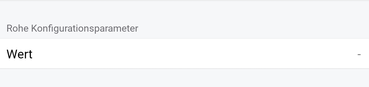

Urg… thank you for confirming. Do you know if it’s possible to configure parameters on the Fibaro RGBW Controller using Homey so that I can achieve the same behaviours with a momentary switch?
Yes, in device setting under “Raw configuration parameters” you can set it.
