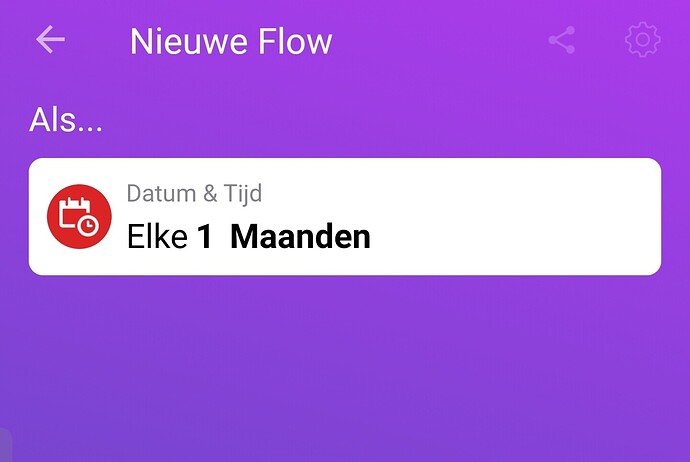

An alternative to Roco’s fine solution:
This should work, but I’ve no info about the time it triggers. My guess is it triggers at the moment when the date & month changes, just after midnight.
Does this actually work for you? I have couple of flows that should trigger every 1 month but they never do! I use them in an advanced flow where I have 2 triggers: “every 1 month” and “the time is 7:00”. Those two go to an “all” card so I thought that whenever the “every 1 month” triggers, it would register and then when it is 7:00 both conditions would be met and the flow would continue but it never does.
The ALL card could be the problem. Try ANY. I have no clue what to do with ALL, it never works. As I understand All means all triggers have to respond at the same time.
What Marcel writes! :point_up_2:
The flow you @Krzysiek want / need is one of these. Note the downside of using the default delay.
This results in a report on every 1st of the month
