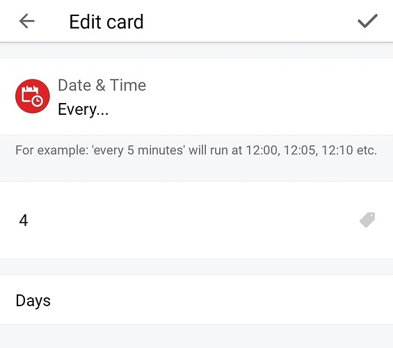

I was aslo trying to set up a flow with “very two days”, or “every 4 days”
looking above, it seems timer doesnt have anymore a fonction “it is a uneven day”.
Any idea how to make it work then?
For what I can remember: There never has been an condition like that,
But Every Day, Every Other day or every 3 or 4 days is possible. Probably all starting at 0u00 every 1st of the month.

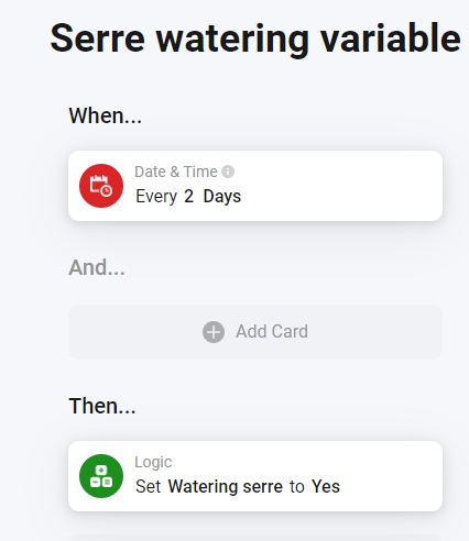

I have no chance anymore to give it a clean starting time set , see my ugly tentative:

You should see the variable as an extra condition to be met, not as a trigger or an alternative to a flow. The logic page is just where you create the variable and where you can see the value. Like putting up a sticky note on the fridge so you remember to water the plants :smiley:
The answer would then be to create a flow that runs every two days (at 0.00) to turn the variable on to set the condition for execution. In addition you should set the variable false when the action is executed.
The flow would be similar to the first one you posted, but you need to remove the and conditions. These would never succeed, because the flow is triggered at 0.00, never at the time the conditions in the and section would allow it to run.
Flow 1: Every two days set variable “water plants” to true
Flow 2: Every day at noon, and when variable “water plants” is true then water the plants, set variable “water plants” to false
It’s not pretty because the date/time triggers do not have the one you actually need, but it will work.

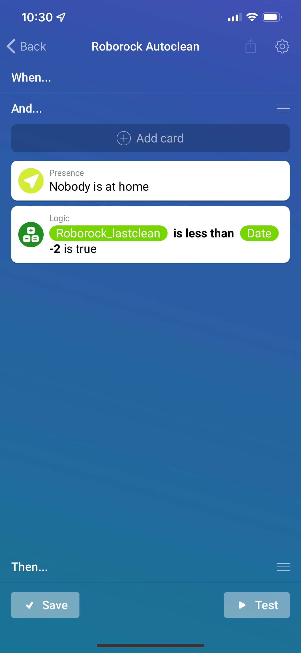

Hey guys… just for the record, I just did this and I think it works with homey. Simply use the default Actions and date objects like:
Maybe helpful for someone…
