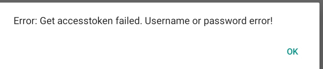

Hi Jurgen,
When trying to login to the Tuya Cloud app I get the below error message (and i’m using the correct login details).
Any idea what could be the cause of this?
Hello Rikjes,
Did you install the last Tuya app on Homey ?
Please reinstall it first and try it again with the good one. Be sure of using the good app on Google or Apple store too
Hope it works than for you it works for me :slight_smile:
Thanks, yes i used the correct/latest version of the app. Today I changed to the Smart Life app instead of Tuya app. This solved the issue so I now managed to add the app to my Homey!
