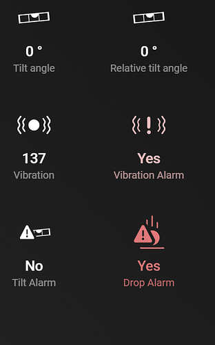

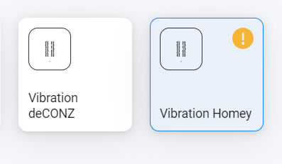

@MadMonkey Some other issues with the vibration sensors. To test I have 1 connected to Homey (Aqara app), and one using deCONZ (Test=drop both at the same time).
  • The deCONZ one does not show an orange alert indicator on the device icon when the alarm triggers (neither on the device info page), see screenshots
  • When I look at the deCONZ sensor alert state, I will periodically see “x minutes ago” while the sensor has not been touched, which is confusing. Does this value change when the device periodically connects to deCONZ (even when no alert was triggered?) I expect it to display the time when it last triggered (this works as expected with the Aqara app).
  • I also noticed this morning that a flow that triggers on the tilt alarm started correctly (so I know an alert triggered), but it did not show up in the alert history of the device (last entry was of yesterday)?
  • Aqara version has one more data field (no big deal)
  • The device icon in Homey does not display the current temperature like other thermostats do (it’s fixed to 10 degrees)?
No alert indicator on deCONZ:
Aqara app (orange on alert):
Deconz (no alert color change):

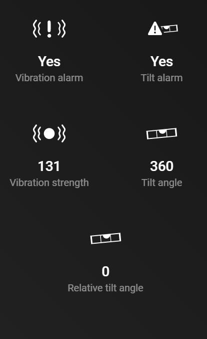

Well, it does seem to trigger an Alarm correctly (Tilt Alarm=Yes, as visible in the screenshot), but it seems like the state is not properly reflected/handled in Homey?
BTW: When I play around with it a bit (drop/tilt/turn etc.), the detected values themselves all look credible.
Oh sorry! I thought you we’re referring to the ‘drop’ alarm. But as I now understand it doesn’t get a alarm with the device icon, even though it has a tilt alarm turned on? If that’s the case I do think @MadMonkey is able to fix this.

It’s actually a real functional issue, not just the alert icon not turning red. The main problem is that the Tilt alarm will activate every few minutes by itself, even if the sensor is not touched. I have a flow that starts when the tilt alert is triggered, and the flow will always start every 5-15 minutes. This means the sensor doesn’t work as expected at the moment.
Repro:
  • Create flow that triggers on Tilt Alert from this sensor
  • Put sensor on the table
  • Wait…
  • Every 5-15 minutes the flow will start (so alert triggered)
  • Stangely enough when I look at the alert history on the device; that info is correct (it will display 1h ago, or 8h ago etc.)
I have tested this with multiple sensors and compared it side by side with one linked to the Aqara app. The one with on the Aqara app will also display the time it was last moved, the one on deCONZ resets every 15m even when there is no movement at all (see the 6 minutes in screenshot, on the other sensor next to it on the same table and connected in the Aqara app, it correctly displayed the time since it was moved).
[Update] From the flow logging you can see that the Tilt alarm triggers by itself every 5-15 minutes (in reality it was only triggered about 2h ago):
