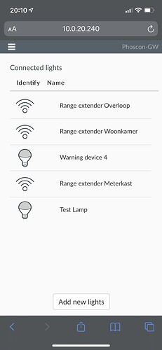

I noticed that deCONZ also added a Warning device to the Lights settings-page. This is weird, I should expect this at the Sensor settings-page.

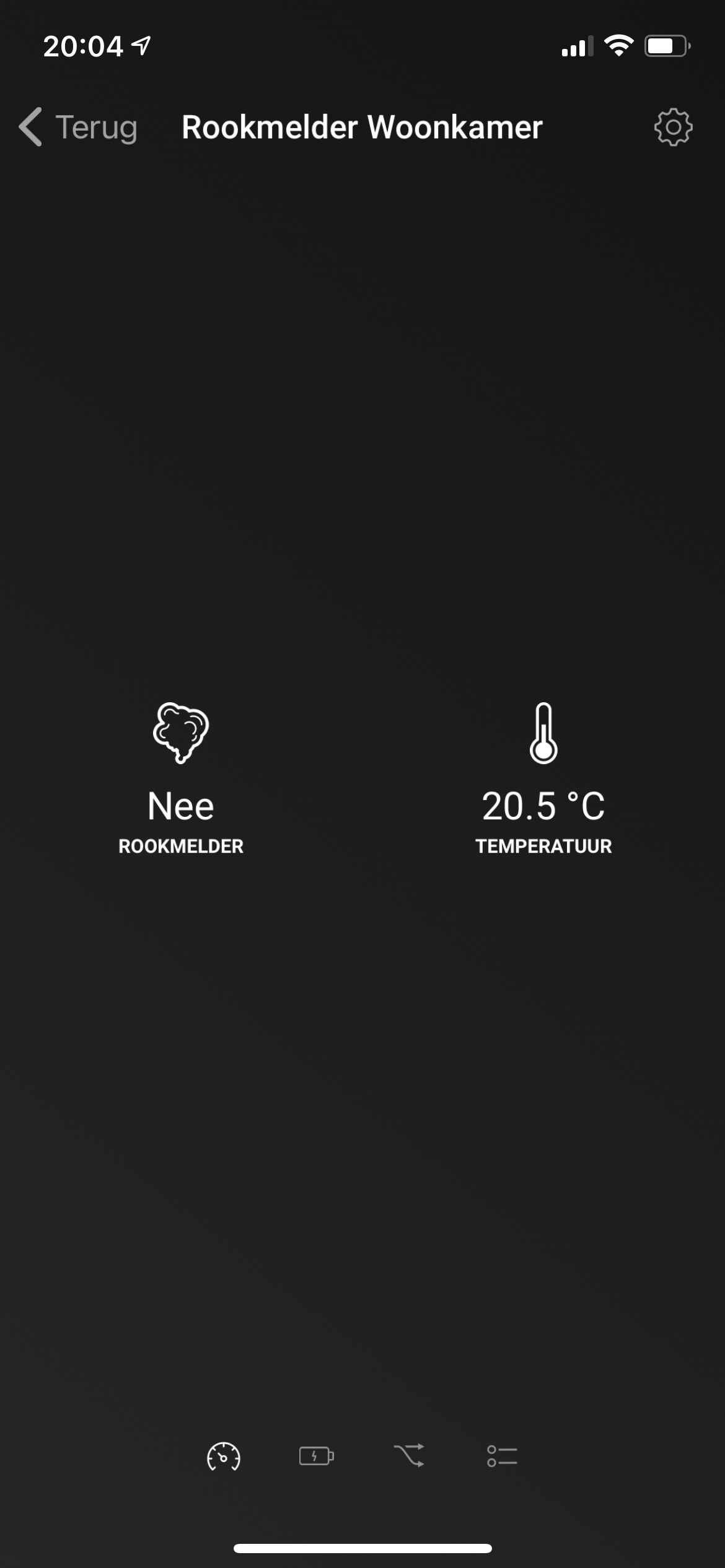

In Homey it reports if there is smoke (not physically tested yet), it displays the room temperature and reports the battery status.

DeConz handles all devices that can perform an action as light and this is why the siren appears there.
Btw: the siren is also supported by homey but you’ll need to add it aa separate device (generic siren). If it really works, I could add it to the smoke sensor device too
