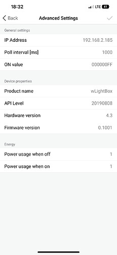

The online store sent a wLightBox v2 (4 channel) instead of a wLightBoxS v2 (1 channel).
The customer service told me to try if it is possible to control only 1 channel with it. If that didn’t work, he would exchange the device for me.
So with the wBox app it’s no problem at all. When I set the device mode to RGBW, MONO or RGB/W, all I have to do is press the switch in the wBox app and the white LED strip is turned on to the previously set brightness (0 - 100%).
This is not possible with the Homey app. If I tap the device tile or the on/off button in the device menu, nothing happens. The LED strip will not be switched on no matter which mode is set in the device menu of the wLightBox (RGBW, MONO, RGB/W). The only way to turn on the LED strip via app is to select “Wight brightness” in the dimming section and move the slider up.
When the LED strip is on, it can be turned off using the device tile or the on/off button. But even if the LED strip is switched off via the device tile or the on/off button, it can’t be switched on again in this way. This has to be done again with the slider.

And what are your wlightbox settings in Homey?
Especially ON value.
The ON value field was empty. Didn’t know that this field must be filled, and with what. A description of this field should definitely helpful. Now it works as it should, with the on/off button and with a flow (turn on).
Thx a lot! :+1:t3:
I’ll add the description. The ON value is the value of all the channels used by wLightBox in format: RRGGBBWW - where RR is red channel, GG is green channel, BB is blue channel and WW is white channel. Every channel is a HEXadecimal value between 00 and FF. So 000000FF sends FF to white channel and 00 to all the other.

Today I received the wLightBoxS v2 (1 channel) and it works like charm. Also the Dim level on ON is a nice feature. Maybe you can add this also to the wLightBox?
