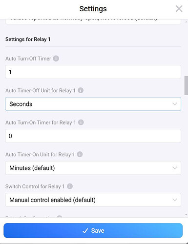

I’m coming from a Hubitat Elevation which had a Zooz specific app to control garage doors when using a ZEN16 (multi relay). Seems homey doesn’t have something similar, however I can simply create a flow which turns on one of the relays on the ZEN16. My thoughts are that I can start a flow, relay turns on, and then using the advanced function of the ZEN16, have the relay turn off after (1) second. This feature is there, but simply doesn’t work, when the relay turns on, it simply stays on. I have attached a screen shot of this setting, am I doing something wrong or missing some other setting?
Just set up a ZEN 16. The auto-off timer didn’t work for me until I manually set parameters 21-23 (Relay Type 1, 2, and 3). I set those to some random value and back to the default (normally open yada yada). Then the timer worked.
I also set pretty much every other param, but I think params 21-23 were the ones that got it working.
