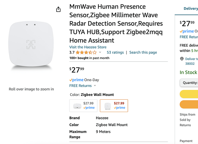

Some presence sensors work. I am using the Sonoff SNZB-06P via the official Sonoff app and another one I bought from Amazon via the Tuya community app (test version). Both are working great with Homey.
Homey must have recently added support for that one, as I have the same sensor that I tried integrating a couple months ago and it would not pair. Thanks, I’ll give it another go
Its the community app by Johan Bendz. Its the test (beta) version. Also Go Cubs Go :slight_smile:
