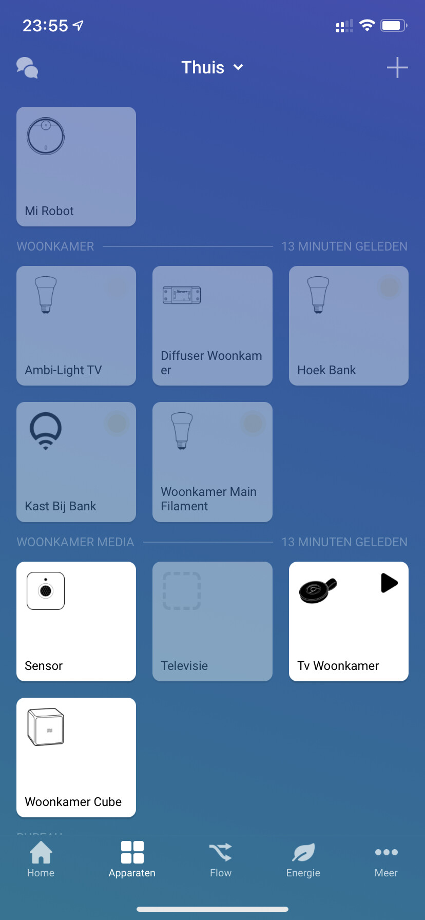

Got the token. Installed the custom app trough CLI and have added the roborock s5 max in Homey so far Hoerayyy!!! On my phone i run the latest Mi Home app from the google store and i can also controll my S5 Max from there. Now i want to have the S5 max also connected to Google home. I tried the three different google connections. when i use “Roborock” i can connect i see the S5 max in google home the S5 Max is available as a device. When i try to controll it i see that it is not responding and google home keeps trying to connect. When i remove the device and try " Mi Roborock" i have the same result. When i try the “Mi Home” there is no device connected. My goal is to control the S5 max by voice (for the wife) and control the S5 max trought flows when we are not at home
Perfect, Thanks for sharing. After al this time i got my Roborock S5 Max connected to Homey. Will be doing some flow testing tomorrow.
