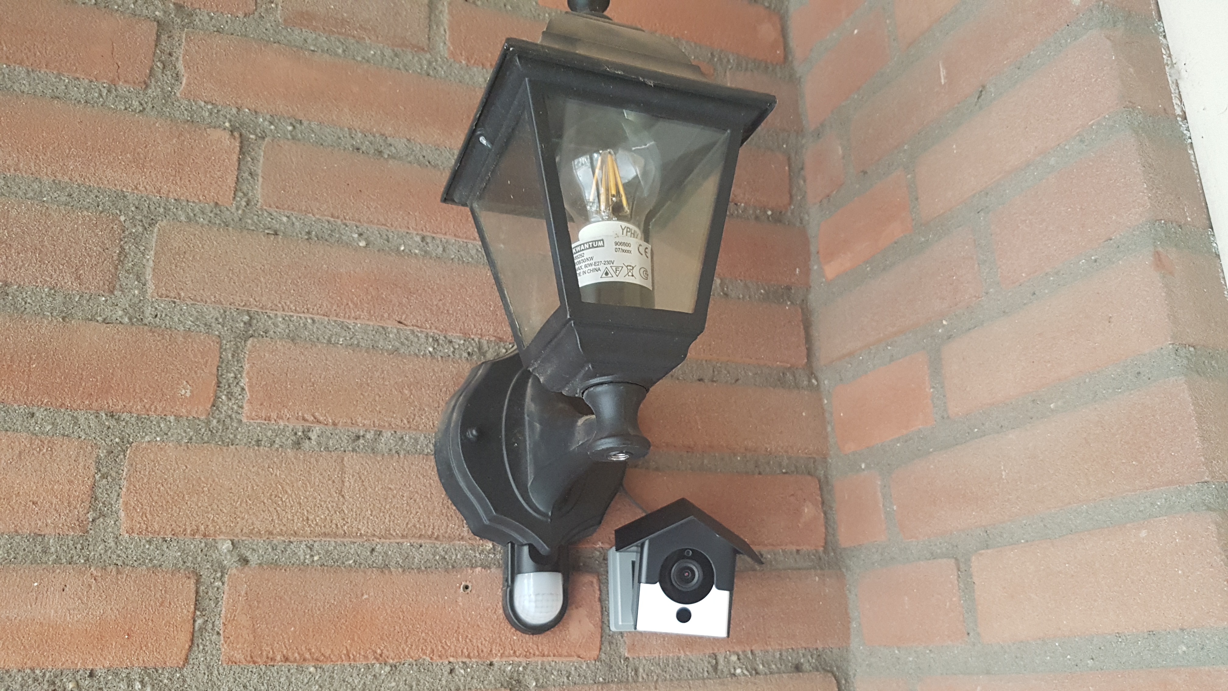

it started a few weeks ago and installed the Xiaomi Fang camera at the front door with the fang hack.
I was able to sent a picture to the phone when the bell was pressed.

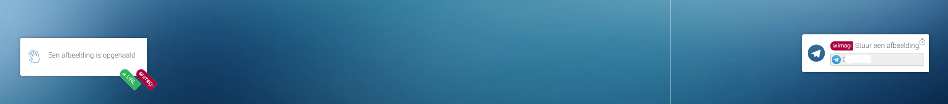

1e one is just for the doorbell itself to send a picture
Here the picture is send.

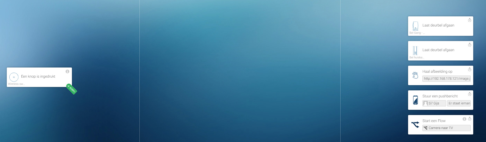

And the flow for the camera to tv
