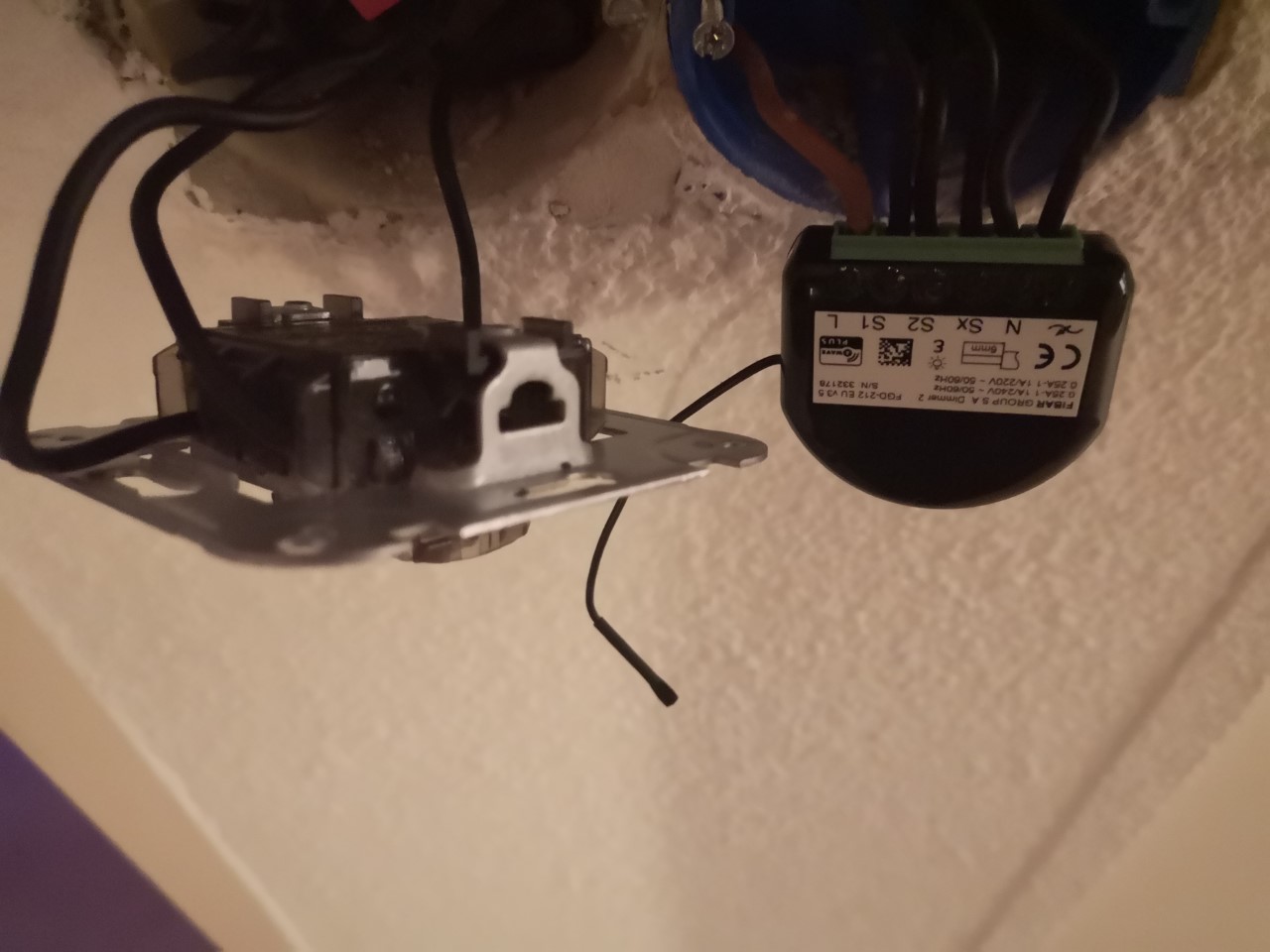

How was the switch/module connected? Can you upload some detailed pictures?

So i made some progress, i replaced the box in my switch (dimmer 2 fibaro) and connected it with homey, but the light keep flickering and i dont know why they do that any idea? plus the box does not react to the switch (meaning does not switch on or off
With ‘box’ you mean the Fibaro-module?

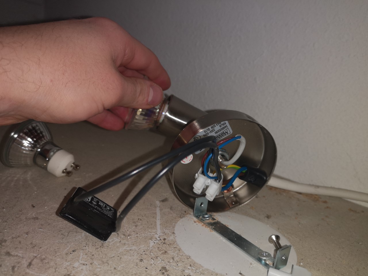

How many watts are you lights? LED I suppose? You need at least 25w if I remember correctly or you risk they start flickering. You can fix this by putting the Fibaro Bypass between your light and module.
Please upload some pictures of how everything is connected :wink:

thanks a lot for your time :slight_smile: yes the lights are 50w each I added a bypass to one of them, in the pictures you cannot see it but they are connected together with a socket in which the plugs from each light is plugged
Why is there a wire in S1 AND S2? Where does the S2-wire go to?

S2 is only used if you have 2 switches connected to the module.
I don’t think you have that, so it shouldn’t be used. That’s why I’m wondering where that wire is going :slight_smile:
Did you check the manual?
If you have 1 switch you need to connect it in one of these ways:
Depending on whether you have a neutral wire or not…
hi yes i do have 2 switches
See, that’s info you should give when you first describe the problem :wink:
I suppose that wire for S2 is OK then…
What happens exactly when you use the switch? Nothing at all?
And did you already do a calibration through Homey? It’s possible it is set for the wrong type of light now (and flickers because of that)
