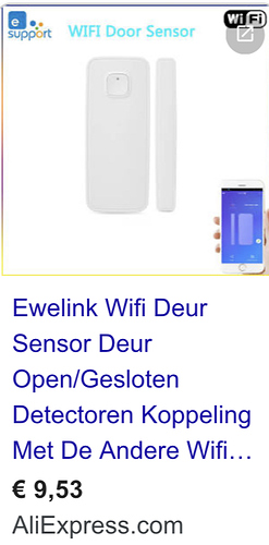

You are right. I needed a wifi door sensor due to distance problems. I tried KAKU and zigbee but they were not abel to bridge the distance to my gate. A lot of wifi sensors are not supported in homey. A direct homey connected wifi sensor i could not find.
The solution which worked for me is:
The large wifi sensor for eWeLink. Connect to the eWeLink app. After that use a IFTTT widget to connect to Homey. For me after all that worked fine. Good luck!

I have added now an adapter to replace the batteries. Wifi and outsite temperatures eat batteries
. Works great now. No problems yet.
