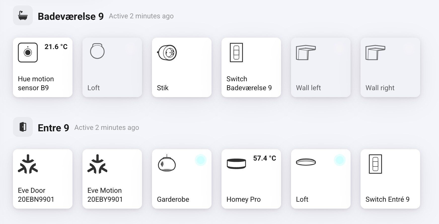

I have such a flow where x is set from a tag/variable. It works perfectly in one room, but not in another, and I am scratching my head why it is so. The room where is works has a Hue motion sensor, and the other room has an Eve motion sensor.
