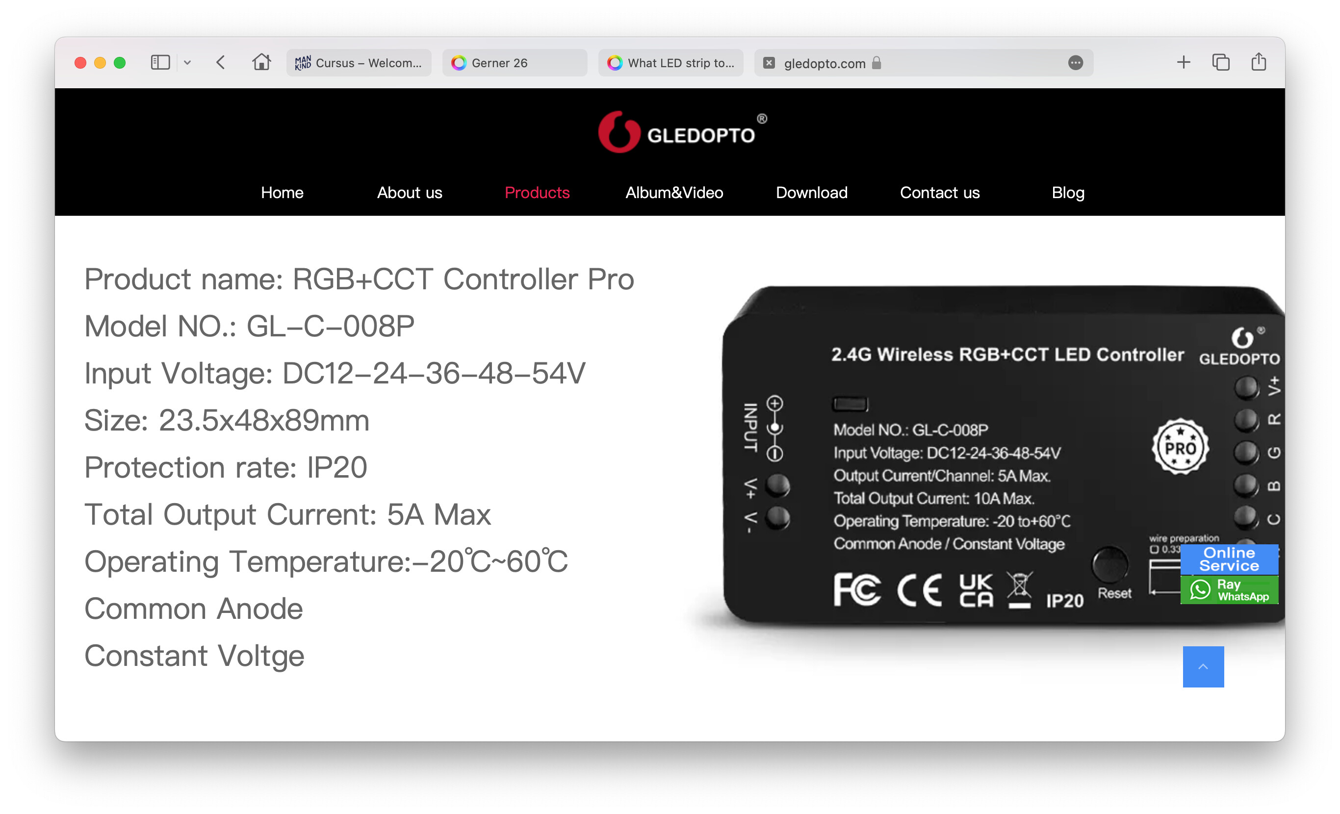

I myself have good experiences with Gledopto, see below is a RGB+CCT = RGBWW controller

Can you suggest a led strip that should work stable with this controller for such distance? Is says 5A per channel and total of 10A so it means it has 2 channels, right? That means I would need 2x 20m to cover 40m. I cannot find any info on the site about a connection schema or something similar.

mhh I think not, I think they mean that R = 1 channel G= 1 channel B= 1 channel, so each RGBCCT letter is its own channel and these can handle 5A independently and all together not more than 10A.
note the higher the voltage the lower the amperage, so you can put a higher voltage on the led strip so that the current is not near the 5 or 10A.
