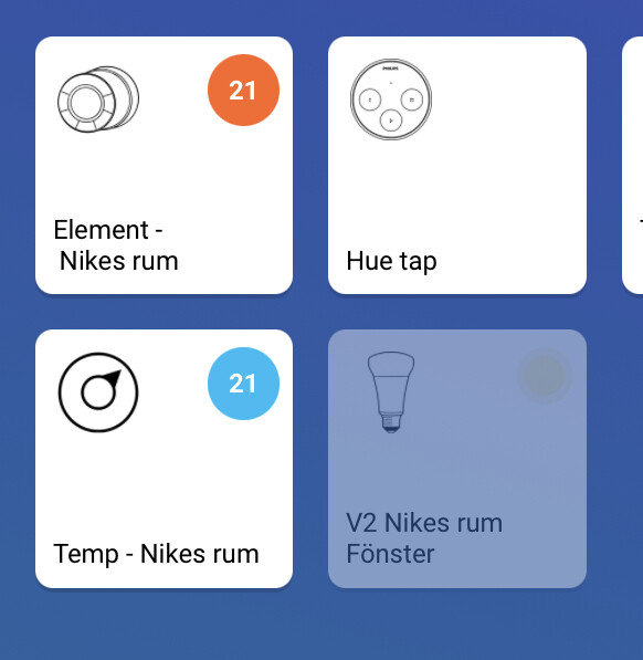

Perhaps I’m stupid, but is it possible to control my heater when it heats or not based on the value in VThermo, instead of the default thermo in heater?
As you can see below the average calculation in VThermo says heater of, but the heater itself is heating based on it’s own thermo. It’s always colder at the window…
Thanks,
It’s not possible without flows, I think.
You can create two flows to adjust the target temperature fo the “Element - Nikes rum”, and that will turn the heater on and off.
Flow 1: When: VThermo “Thermostat turned on” -> Then: set target temperature of “Element - Nikes rum” to a high value.
Flow 2: When: VThermo “Thermostat turned off” -> Then: set target temperature of “Element - Nikes rum” to a low value.
