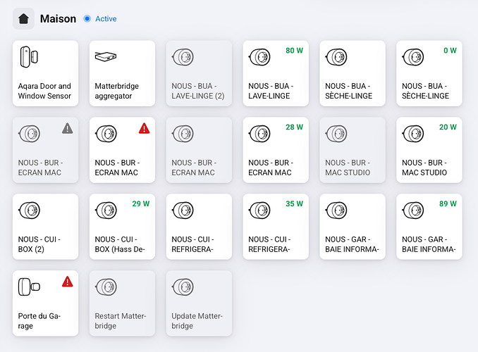

I’m using the Matterbridge module in my Home Assistant Platform to share some Zigbee devices with Homey. The Matterbridge module exposes these devices using Matter.
The integration within Homey is working fine, but I’m encountering an issue where the devices appear twice. Does anyone else have this problem? I’m not sure if it’s an issue with the Matterbridge module or Homey Pro.

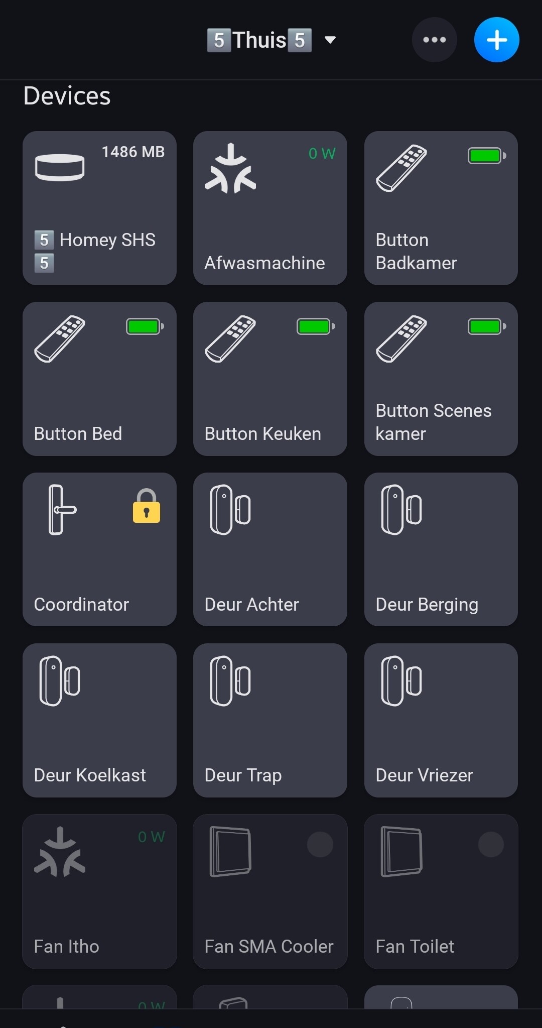

But thank you too, I didn’t know about MatterBridges’ existence, so I just tried it with Homey SHS, and it went fine, 62 devices were added, no doubles.
I added the zigbee2mqtt add-in to the MatterBridge add-on, not sure what it adds to it. At least it connects directly with MQTT Broker:
