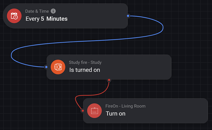

I don’t think it could be a reliable solution because you’d have to test the status on a regular basis and the power might have blinked off, then on in that time however, it could work if the outage is long enough.
This is what a flow could look like:
It wakes up every 5 minutes and checks whether a plug is turned on. The red line from the bottom is followed if there’s a problem with the card.
