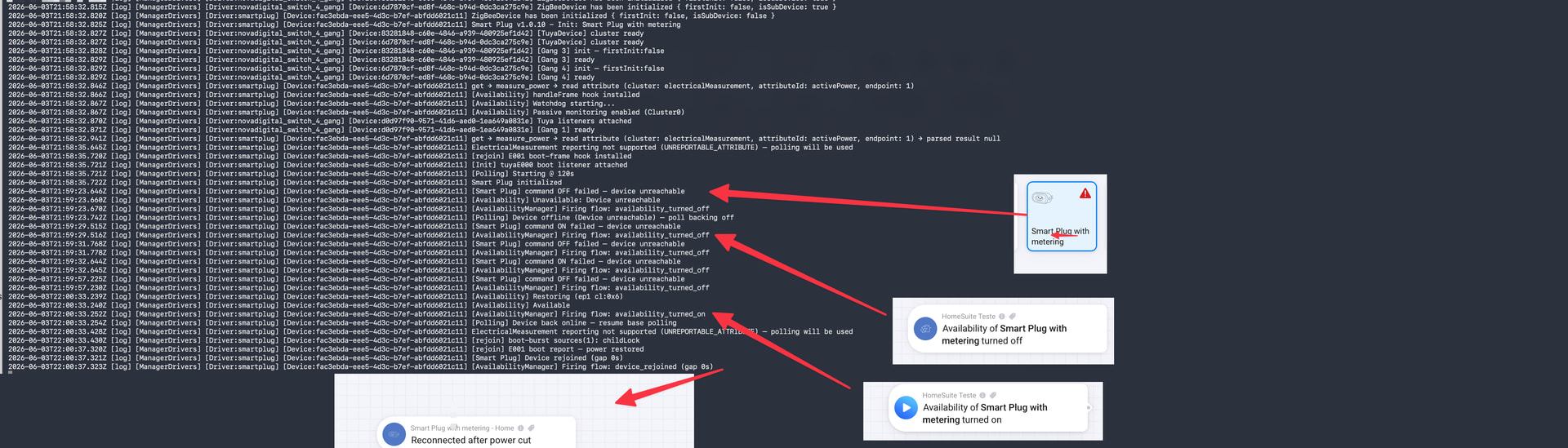

Main features
  • Availability — detects when a mains device loses power or drops off the network, instead of silently looking “online”.
  • Reconnect-after-power-cut trigger — fires on the device’s boot/rejoin, even for short outages.
  • Connected-devices info — for multi-gang devices, shows the group and which sub-device is the main.
  • Smart polling — exponential backoff (no hammering offline devices) + jittered timing so devices don’t all report at the same instant.
  • No dead settings — firmware options the hardware doesn’t actually have (relay LED, gas-detector tamper) are hidden, not shown as non-functional.
  • Device-specific — native inching, toggle/momentary switch mode, per-gang power-on, persistent backlight, working Sonoff ZBMINIR2 turbo mode.
Availability strategy
Homey exposes little operational Zigbee state, so this layer is heuristic (probabilistic, not deterministic):
  • passive heartbeat monitoring
  • adaptive timeout windows
  • exponential-backoff polling
  • reconnect detection after power restore
