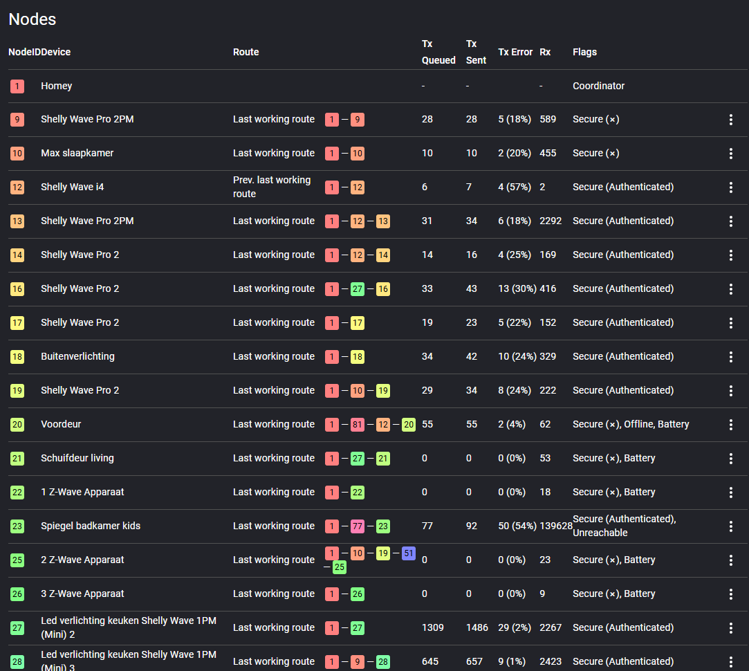

As you can see from the screenshot i have high amounts of tx errors on my whole network
This has always been like this.
What am I doing wrong? How can I solve this?
And even after restart, the proportion of Tx error is the same ?
Looking on your nodes, this one doesn’t look heathy at all…
Try to cut the power from it for few second, restart Homey and check, if it’s the same.
If it is the same, please contact Athom support with this picture and all your steps you made + also generate diag. report using Homey Developer Tools
