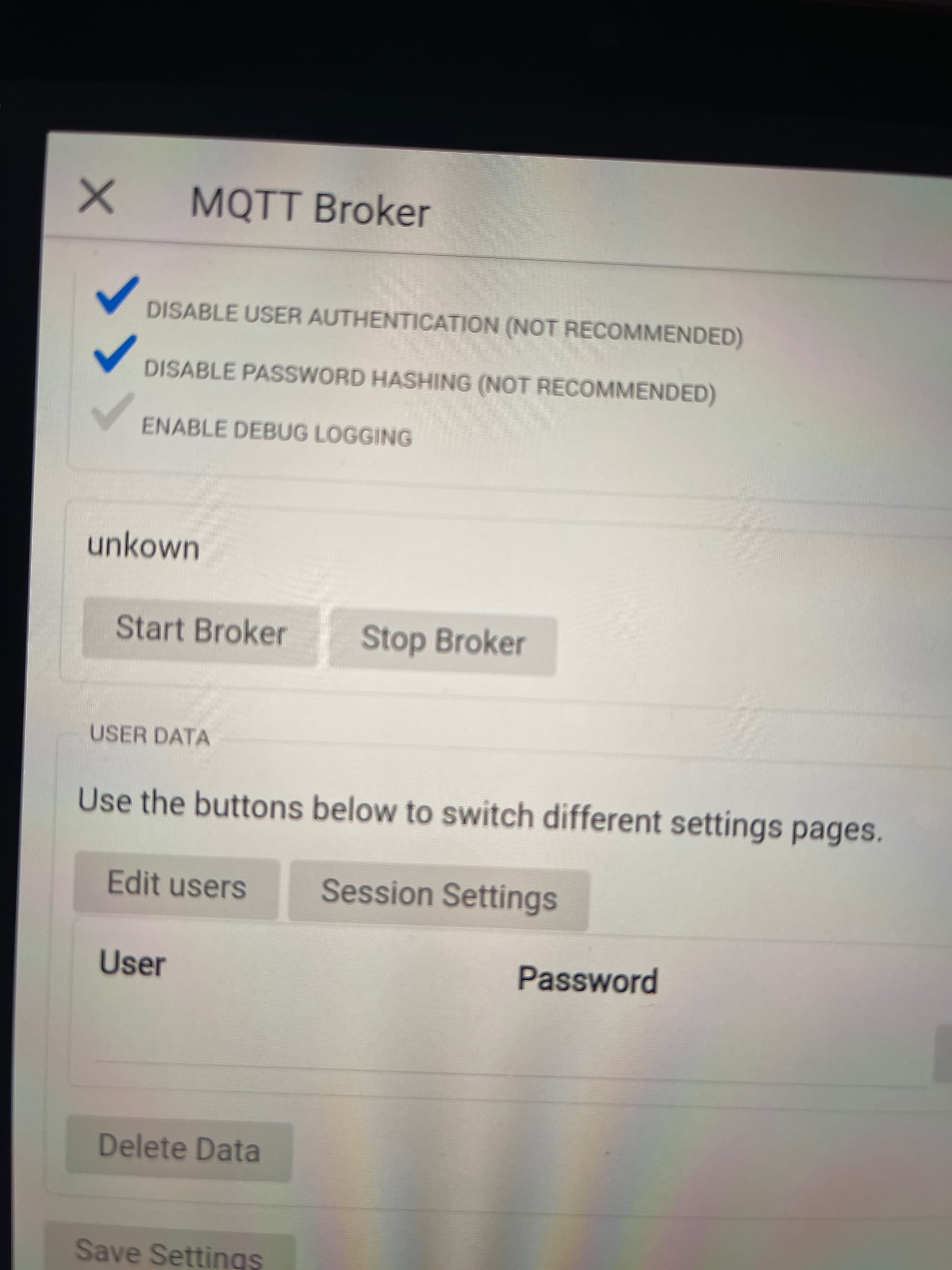

Why do I get unknown on start broker?
The field under user password fill in?
Unknown?? I have never seen this message. Here my settings.

Thanks! I found the answer I was using 8883 port changed it to 1883 now it’s fine!

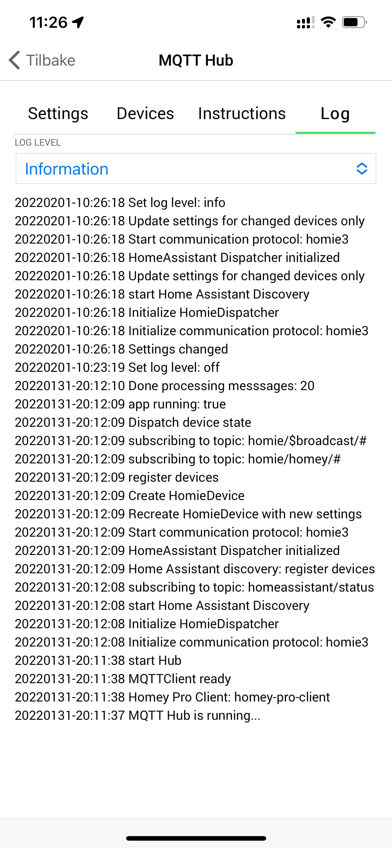

One more question! How do you know this is working? Do I need to create some flows in mqtt hub or is the broker client talking automatically to each other? The log homey 2(client) and homey 1(broker) log the hub in homey broker are switching off why?
Install MQTT Explorer. Then you can view all messages passing by.

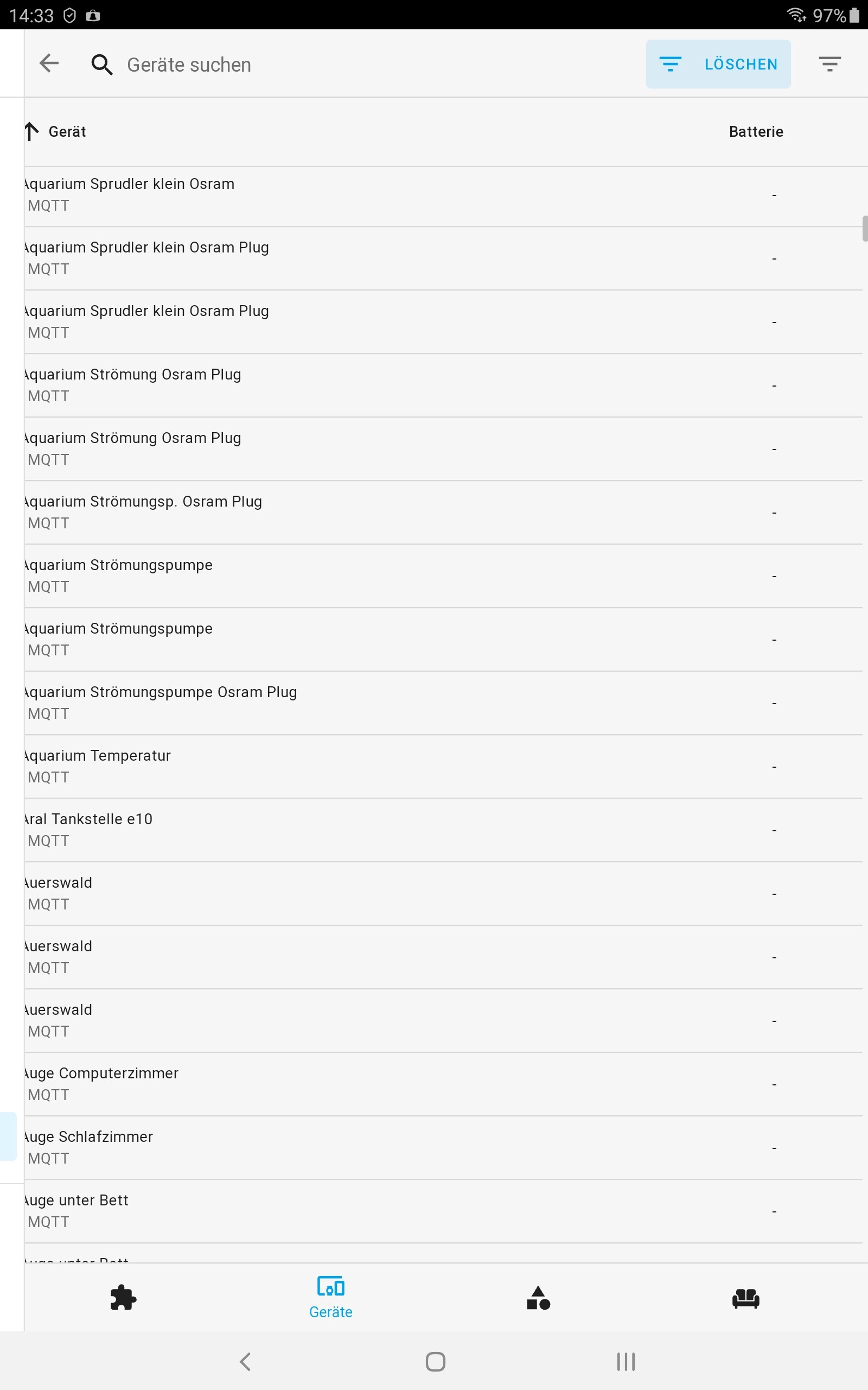

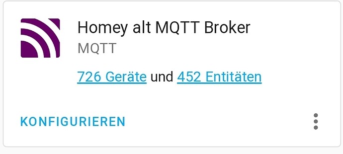

I have always had my MQTT running via the Home Assistant. All Homey devices were imported into HA via MQTT client.
From HA, I imported the required nodes back to the 2nd Homey using the Homey Home Assistant app. The big advantage was that I could switch all actuators with Homey 1, Home Assistant and Homey 2.

The hub is only there to publish all Homey devices in the broker. I had the hub running on both Homeys.
Home Assistant Broker Homey ID
The client app is only there to receive the messages from the broker. Enter the broker iD here as well.

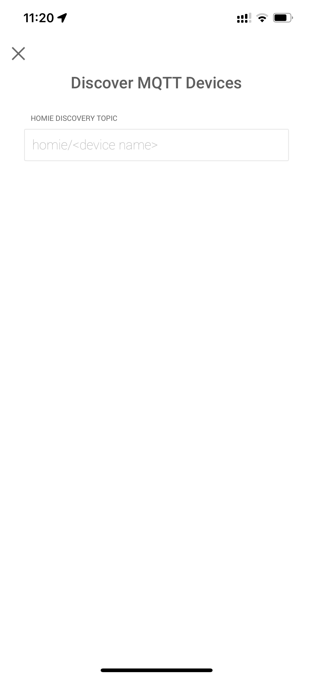

Broker and clients are talking👍 What is supposed to type in here?
