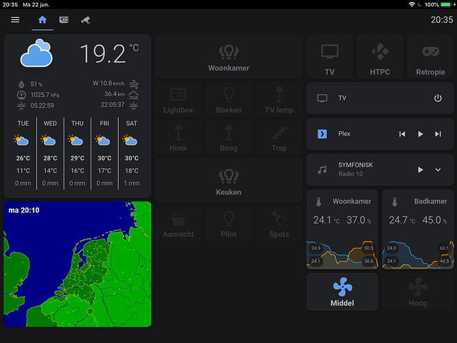

This way I’m using HA as Dashboard on an tablet.
I use the lovelace GUI with some custom controls. You wil find many thins to extend HA in the home assistand forum.
For dislaying I use the fully kiosk browser in android. In this browser you can set individual zoom (which ist not possible this way in other android apps/browser).
My Dashboard looks like this:

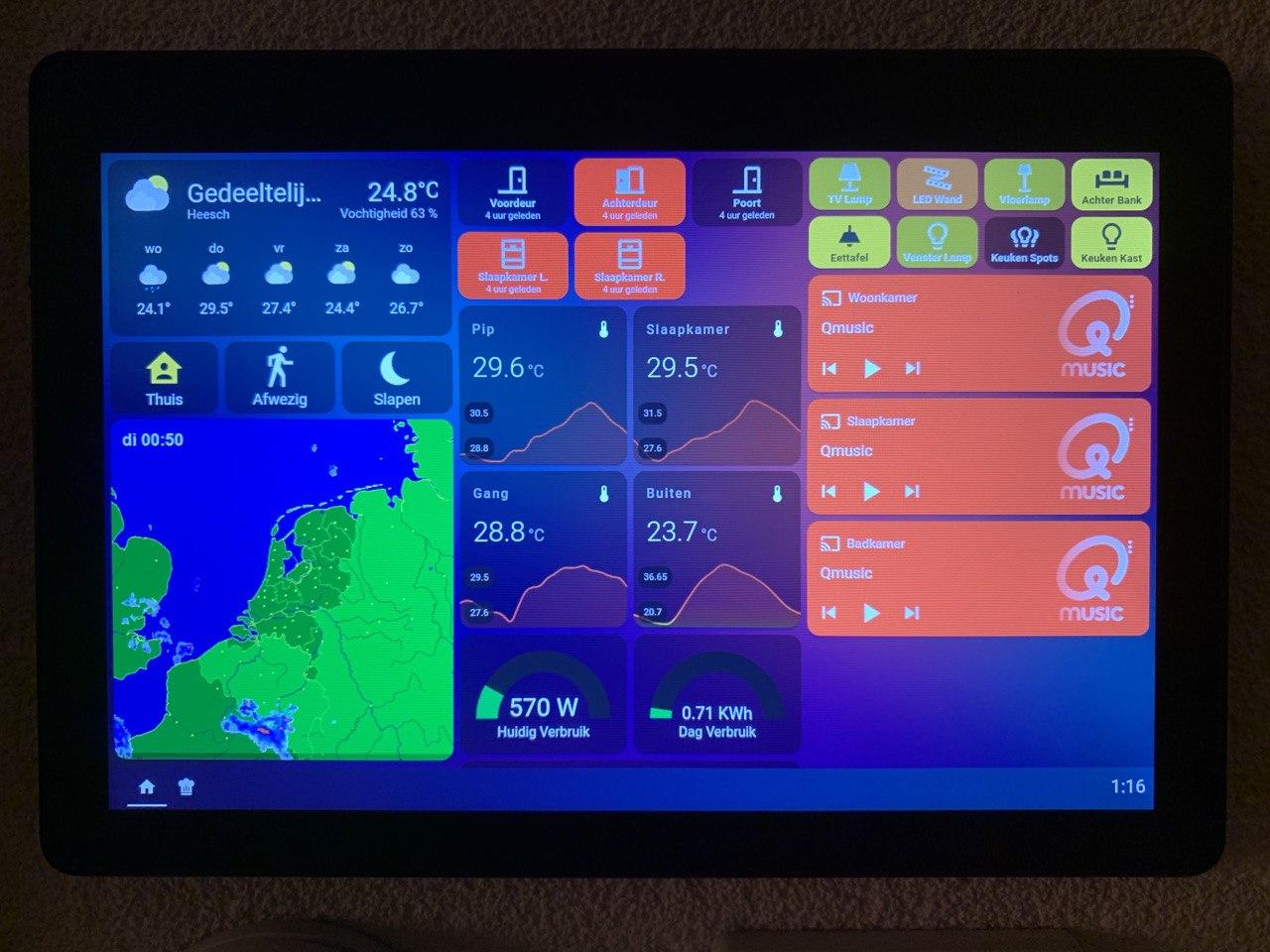

Hi!
Thanks to this topic I’ve managed to create a dashboard which fits my needs! Thanks to everyone who’ve shared their knowledge over here.
Used a Raspberry Pi 3b+ with Home Assistant latest version, iOS Dark Theme, and some custom apps like ‘mini graph card’ , ‘buienradar’ and ‘button-card’ . Every sensor/switch/thermostat is loaded from Homey with MQTT except Sonos, which got added to HA directly so I could use the mediaplayer widget (auto discovered).
THANK YOU THANK THANK YOU!
